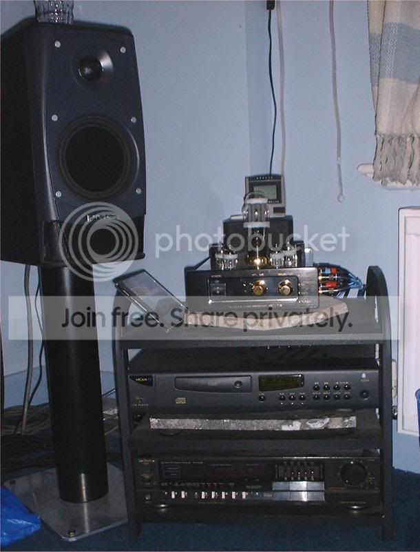

Haha.. I used to have half squash balls under an Alpha 9 :)
You can just about see them in this old picture
