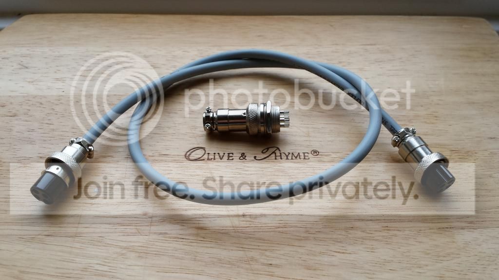

I've been promising myself a nicer powercord to link the Dino to the PSU for while and I finally got around to it a few weeks ago.
Here is it:
The cable is multi-stranded copper and is available from Farnell priced at about £4 per meter. The connectors are the same as those used by Trichord and are available from eBay.
The new cable is about 70cm long which is all I need in my installation.
Any chance you could give me a link to the specific Trichord PSU connector. I think i know which type but would appreciate confirmation.
I have a Trichord Delphini MKII and would like to see if i can improve on their standard cable.
