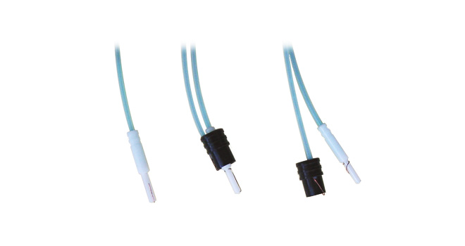

Why not use plastic, something that presses the cable against the insides of the plug à lá 47?
It's the best connector (period)
