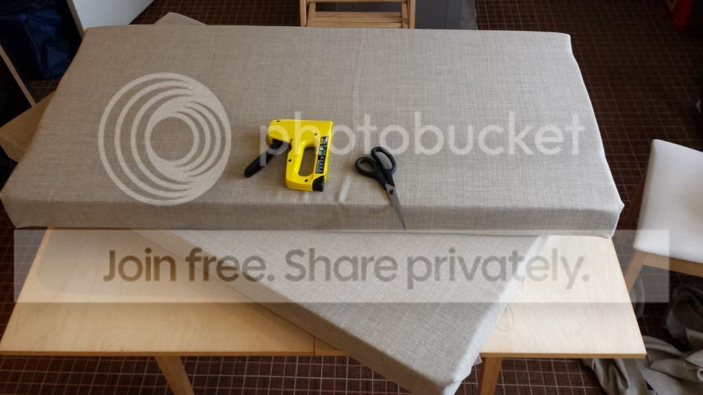

I've purchased two 600x1200mm 3" thick acoustic foam slabs which are mounted onto 6mm MDF. I've been doing some listening with these slabs just resting in the alcoves (see photo) and they make an amazing difference.
Please excuse the dodgy decor and carpet, I haven't redecorated yet!
I got these panels from a company called Advanced Acoustics in Mansfield. They cut them and mounted them onto MDF while I waited. They also offer do 1" and 2" thickness options but I went for the 3" as this has much better absorption specs in the low frequency ranges. They call this material "Acousti-Slab".
I'm going to mount the panels on the wall with a small air gap behind them as recommended by Simon and I bought some nice neutral coloured soft linen cloth to cover them in. I'll post pics when they are finished.

Oops, I wasn't thinking about corner placement when I bought such large flat panels. Still I'm getting a very useful improvement with them against the side wall as pictured.
I suppose I could cut each panel in half lengthways to create narrower panels to mount across the corners but I've already covered the panels in fabric now so I try them as they are to begin with.
After taking this photo I added some more staples and tensioned the fabric a little more to pull out the remaining creases.

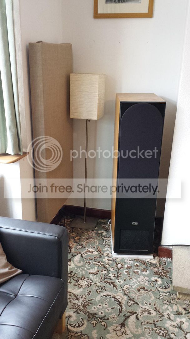

Last night I mounted the panels to the wall (see pic). The panels hang from nylon cord so they are free to resonate and at the moment they are set up with a 30mm air gap behind.
I'll move them further out from the wall if after some listening I feel I still need more bass absorption.
My next plan is to further improve the situation with the floor under the speakers. Watch this space....

That's a very good suggestion but.....The room is divided into two with a staircase. With the speakers moved further away from the back wall I feel that the listening position becomes too close to the speakers. I can't move the listening position further back because the stairs get in the way.
The good news is that the acoustic panels have been hugely beneficial and I'm now much happier with how everything sounds.

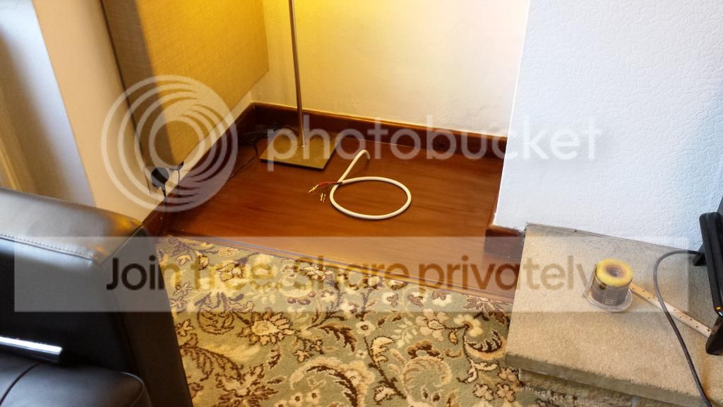

My effort to stiffen and improve the floor are now finished.
What I've done is based upon an old Linn recommendation I read somewhere with a few extra tweaks. Here's a summary:
  • Extra 2"x4" brace beams added at right angles between the joists under the speakers. I didn't take a pic of this as it's too dark under there.
  • Floorboards screwed down tight nice and tight along joists where possible.
  • I then cut two sheets of 20mm MDF to size/shape so that they'd fit in the alcoves. These were stuck down using silicone sealant as an adhesive. I was very generous with the silicone and used about 500g of it per side. My thinking was that the viscoelastic (if that's the correct term) material properties of the silicone sealant sandwiched between the floorboards and MDF would have good dampening properties. Once the MDF sheets were in place I weighted each sheet with loads of heavy stuff and left it overnight to set.
    Some wood stain, varnish and a bit of trim along the front keeps it all looking respectable. The floor under the alcoves is now really solid.

Sorry, my post was badly worded. There is one sheet of MDF per alcove (two sheets in total) so the new floor is 20mm higher than the underlying floorboards. The carpet and underlay is fairly thick and then the carpet grip-rod strip raises the carpets edge a touch more giving the impression that everything is level.
It has made a substantial improvement.
