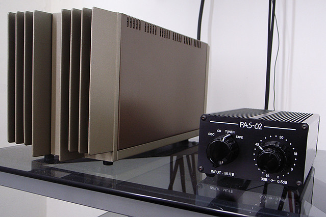

I've got an old Audio Synthesis PAS-02 stepped attenuator, it dates from about 1993 IIRC:
I like it; it's simple, does the job, as green as it can be as it uses no power, and has nothing in it that will wear out / need servicing. Just the thing for the TV/office system that's on all day.
