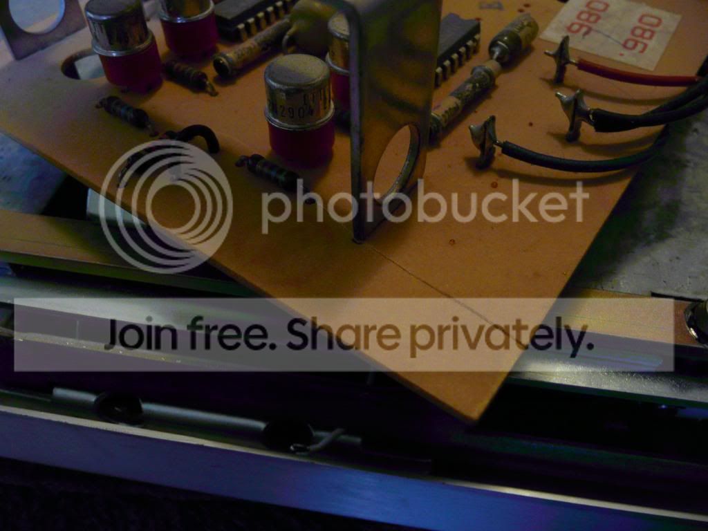

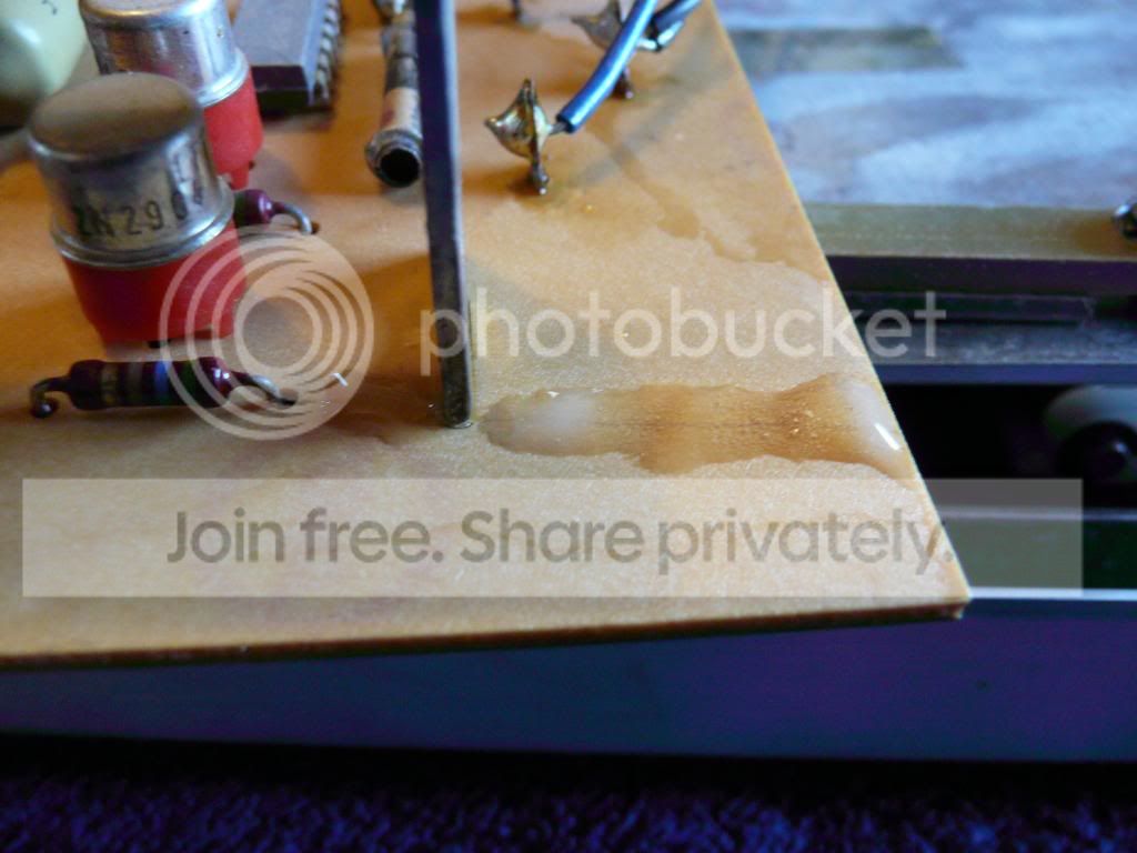

I'm pleased with the repair which I managed to make to the circuit board.

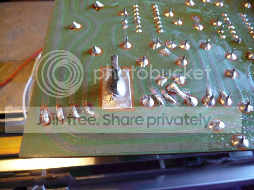

Firstly I used a strong elastic band to 'clamp' the PCB together and squeeze the crack tight. I then applied bead of araldite to the top surface to make the area structurally sound again.
Once I'd done that I carefully scraped away the enamel either side of the crack on the PCB copper traces and then with the help of a flux pen soldered a bridge across the join.

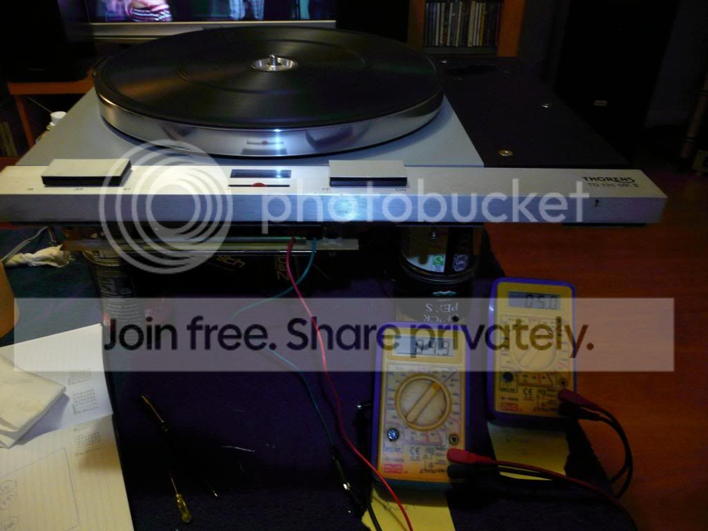

After doing this the turntable ran! Here I'm setting the voltages for the first and second motor phases together with making adjustments to the fine speed control. I do this maybe once a year on my other my other TD125 and it can make quite a difference to the smooth running of the motor.

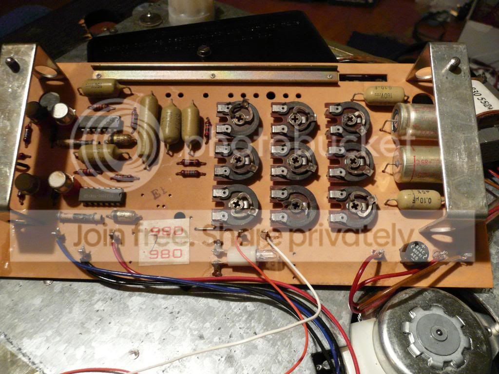

The speed control circuit board has two large 1000uF axial electrolytic caps for the power supply. These tested well within spec so I have left them in for now.
I managed to get the deck running at 33rpm and 45rpm but with 16rpm selected the motor would just vibrate back and forth or will just about rotate with a very jerky motion but won't turn smoothly.

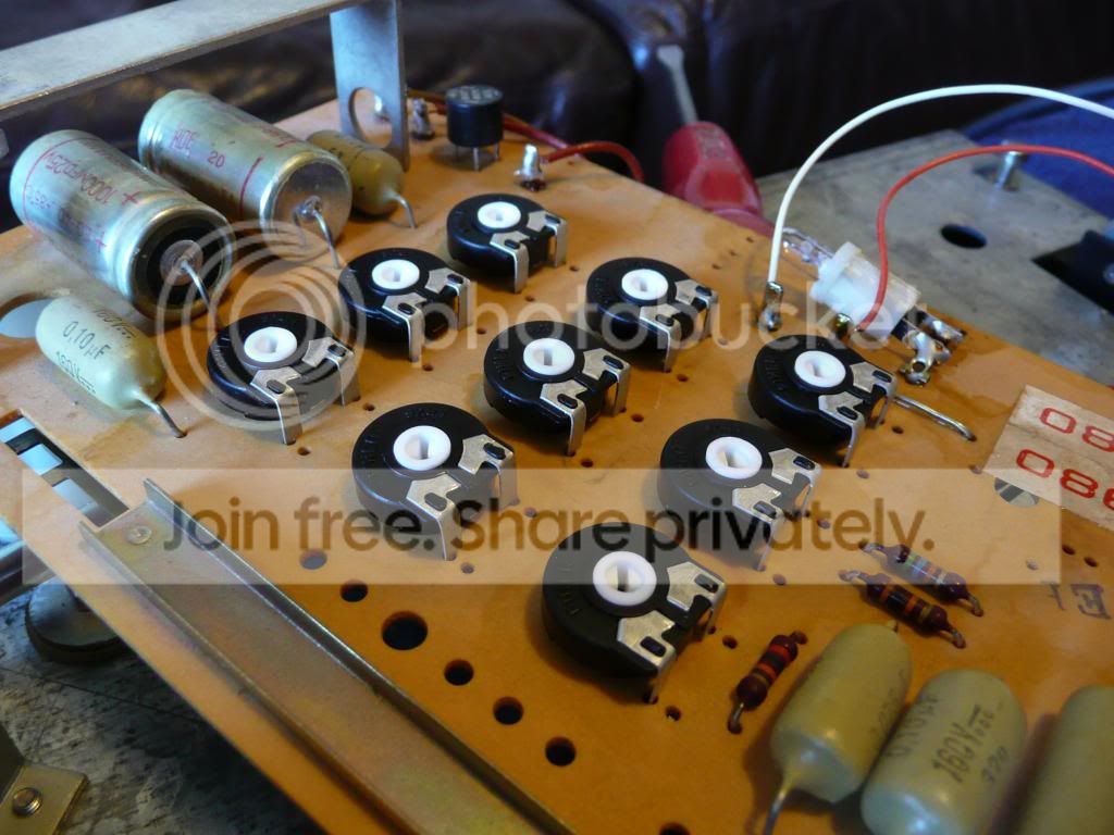

I though that maybe the the contacts on one of the potentiometers used to adjust the motor phase voltages looking loose, as if it wasn't in firm contact with the horseshoe shaped pad which it sits on. Foolishly I tried to bend the contacts down with a pair of tweezers. That turned out to be a stupid idea as the metal was incredibly brittle and the contact snapped clean off. I don't know if maybe it was already cracked?
So now I need to find a replacement for at least one of these big old potentiometers. If I can find a suitable more reliable modern replacement I may replace them all for good measure.
Can anyone help point me in the right direction for a suitable replacement part? All of the modern potentiometers seem to be much much smaller. The are 500 ohm BTW.
Pound coin for scale.
Never mind, I've found some suitable replacement potentiometers and I've just ordered them.

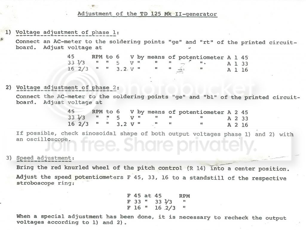

Here are the instructions in the service manual:
I can carry out the voltage adjustments for phase 1 but I cannot get any sensible readings when trying to adjust phase 2. Turning the trim pots when trying to adjust phase 2 doesn't seem to do anything.
I'm going to need some help with this one!

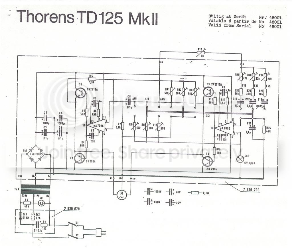

Here is the circuit:
Any suggestions?

Woohoo! I've managed to fix it all my own little lonesome :D
Transistors T1 and T2 turned out to be defective. Also the speed selector switch needed a really good clean.
I've been able to set the phase 1 and phase 2 motor voltages and the speed control voltages and it's now running well at all three speeds with the strobe markings nice and static.
To test the circuit I just some generic plastic cased (TO92?) NPN and PNP transistors at locations T1 and T2, just what I had in my spare parts bin. The originals have a metal can type construction (TO39?) and get quite hot. I'm not sure if the small plastic ones which I have just fitted can cope with the heat so I'm going to swap them out for original specification metal capped devices before leaving it switched on for any length of time.
The original component at T1 is a 2N2218A and T2 is a 2N2904 PNP.

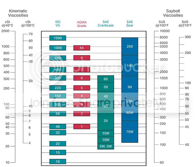

Older gear oils often contained Sulphur or Phosphorous based extreme pressure (EP) additives which are well known to be corrosive to copper containing 'yellow metals' such as bronze.
Modern gear oils of the type used in manual car transmissions usually contain a less aggressive form of Sulphur EP additive which is not corrosive to yellow metals at low temperatures. This is why you can realistically get away with using a modern GL4 gear oils in a bronze TT bearing without any noticeable problems in the short term.
However that doesn't mean that they can be considered safe to use.
The EP additives bond to the hard steel gears creating a sacrificial coating which prevents metal to metal wear of the gears. Problems can arise when a hard steel surface in in contact with a soft yellow metal bearing. What happens is that the EP additives form a coating on the yellow metal bearing. As this coating is worn off it takes with it a microscopic layer of bearing and so causes erosion of the bearing surface.
Gear oils with a higher number rating usually contain higher concentrations of EP additives so a GL5 oil has more of these additives than a GL4 oil.
Engine oil would be a safer bet for use in a bronze TT bearing. Car engines have bronze bearing surfaces (e.g. valve guides) so obviously engine oils need to be safe to use with yellow metals. However engine oils also contain other additive packages such as detergents which are at best of no use to a TT bearing and at worst may actually be undesirable. However given that most of us have easy access to engine oil it would be my default recommendation for the average owner.
An even better choice would be a high quality oil of an appropriate viscosity manufactured from a high quality base stock and containing no additives which may be considered harmful to a bronze TT bearing. Good quality air compressor oil would fit the bill perfectly.
If your TT bearing is a little worn it may be beneficial to use a higher viscosity oil than originally specified by the manufacturer. You need to aware though that comparing oil viscosity ratings can be a little confusing though. For example an 75w gear oil is actually about the same viscosity as a 20w engine oil.
Here is a useful comparison chart:
Previously in my own TD125 I used to use a very high quality 20w50 engine oil designed for racing classic minis however more recently I have swapped over to a fully synthetic ISO 46 compressor oil which I believe is pretty much ideal. If you feel a thicker oil may be better then an ISO 68 compressor oil may be a good choice.
