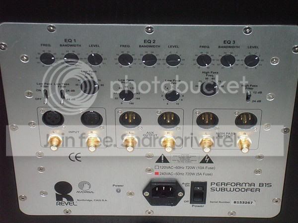

I have been looking at the Revel B15 Sub to partner my M22 Performa standmounters for some time.
Could I use my Current Accuphase E-212 Amp to feed signal into the B15 via the tape - out? The amp has no other output options except the speaker terminals.
I have looked at the manual on the Revel Website and I can't see this topology listed. However I am still wondering if it would work and if so, how successfully?
The B15 rear panel looks like this:
Unfortunately, no.
The inputs are line level rca or balanced only and for those you need a pre-amp out from your amp so that the level increases as you turn the volume up.
Plugging the Tape outs into the sub will give you a constant maximum (line) level and could damage the sub.
You need to look for a subwoofer which has high level inputs or an amp with a pre out.
Sorry mate :(
