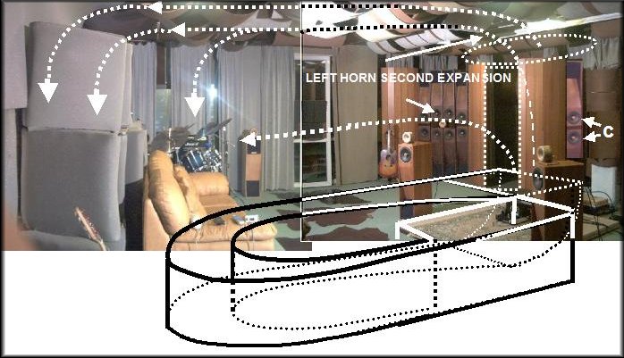

These need no (extra) subwoofer
http://www.royaldevice.com/customita3.htm
