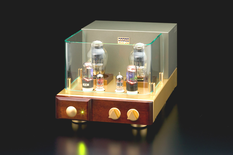

It's not this amp?

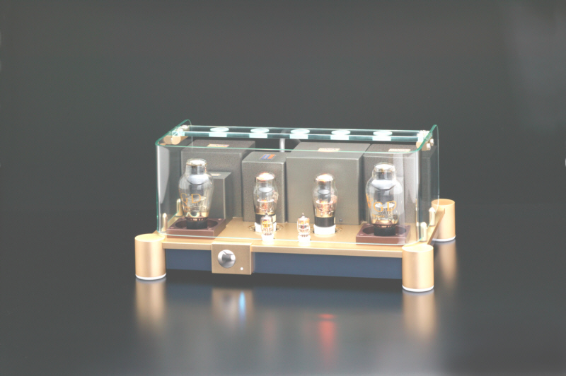

or this one
They both have a input impedance of 100k Ohms & a 1v senistivity. It's not the most senistive but has a fairly high input impedance. Usually passive work better with power amps of a much higher sensitive input. (lower value of voltage).
Hi - it's the first one listed MD300B -most definitely better though a preamp and with the passive pot turned back about a quarter.
