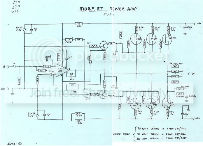

This TdP circuit sounds rather nice, and it can work perfectly well with just one pair of output devices for an even simpler circuit:
Opamp, buffer stage with a gain of roughly 3x, driving mosfets - yup, that'll work ;)
The devil is in all those little caps to strap it down; and the 'bias' setting arangement is , um, rudimentary. And making a clone using a 'modern' opamp would be a whole new bundle of fun :D
