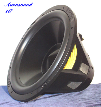

in my listening room ceiling will be a nine square foot rectangular hole. above it, in the loft, will be a manifold covering the hole and open into it. all other sides are sealed, and facing each other on each long side will be two 18" drivers, four in total. this will be my infinitely baffled sub.
the IB will be the same distance from the listening position as the main speakers (alon phalanx, also open baffle), and midway between them. the sub will recieve only sub 40hz signal, probably crossing over at 36hz.

I have been looking at implementing a similar system, possibly using modules from http://www.hypex.nl/
I have however been unable to find suitable drivers in Europe.
Which 18" versions are you intending to use ?
