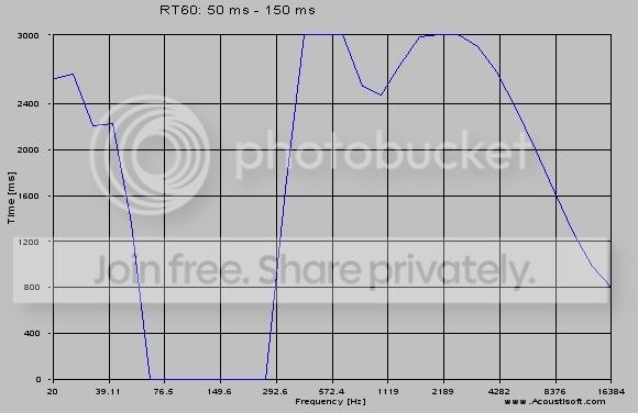

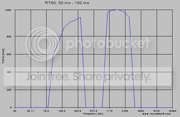

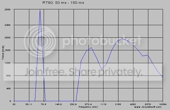

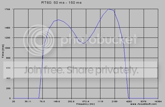

This took me a while, the shots are in the same order as the measurements shown in the last posts:
1. No treatment
2. All corners treated
3. Doubled up treatment behind the speakers only
4. Doubled up behind the speakers and fireplace treated too
As I understand it the RT/60 time is a measurement of how long a particular frequency takes to decay by 60db.
I think the measurements are faulty. They are changing way too wildly. Also at some points it seems to be reading '0' decay time. That is really quite strange. Like on the first and second graph there is no decay at all between about 76Hz and 292Hz, then on the third one it is over one and a half seconds.
Try doing the same measurement 3 or 4 times and see if it gives inconsistent results.
If it does, please post pictures of the RT60 time on each repeat of the measurement and also a copy of each impulse response.
I didn't think they looked right but I can't seem to get them to look any better so up they went. Although no expert I can understand how a decay time of 0 is probably not realistic :D.
Any ideas why this happened, other than the fact that the measurement is faulty?
Does the generation of accurate RT60 depend on the particular type of test being run? For example MLS / Sweep / Hybrid etc?

It looks like a similar problem to what I was having, only worse. I got R+D after what you said Scott, but I still waiting for the replacement measurement mic to arrive so I will see how it works later on.
It's a slight worry that the program puts out RT results that are so weird. What does the heading RT60: 50ms - 150ms refer to??

The problem with my RT60 plots was my selection of too long a time period when generating them:
The writer of R+D (Doug Plumb) says...
'The zeroed parts of the RT60 measurement are that way because there was too much noise at those frequencies to get good readings. Change your time limits and re-calculate.'
