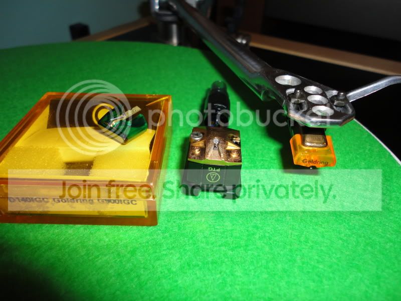

About 18 months go I bought a couple of NOS Goldring G900IGC styli, with the intention of finding a spare 900 Series body. As luck would have it I managed to find a boxed 910IGC complete with sealed accessories and papers, with a claimed use of around 40 hours. Looks brand new to me using a small scope so I'm well pleased.
Styli are interchangeable within the range.

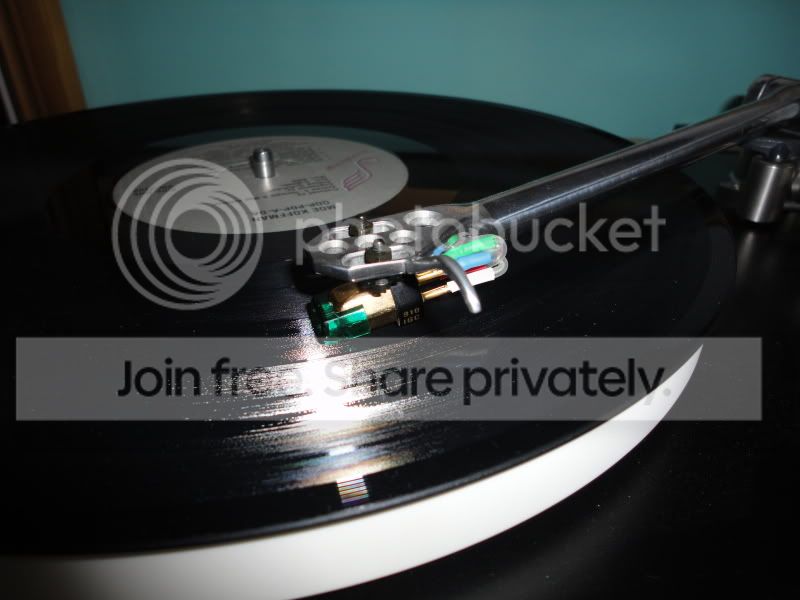

Very light and quite high in compliance by today's standards - the 910/920 sit around 26cu which ideally needs a low mass arm. The 900 has very high compliance at 42cu but these are for lateral compliance, with vertical is clearly much lower, and arguably the more important to get right. Fortunately they are well damped, and I've found a 900 in a Rega arm is pretty well behaved, certainly if your phono stage properly conforms to RIAA.....
They weigh 4gm which is very light and only the old Ortofon OMs will be lighter. The smaller of the Michell TecnoWeight options balances perfectly on the RB1000 when right up to the pivot, which is just what we want.

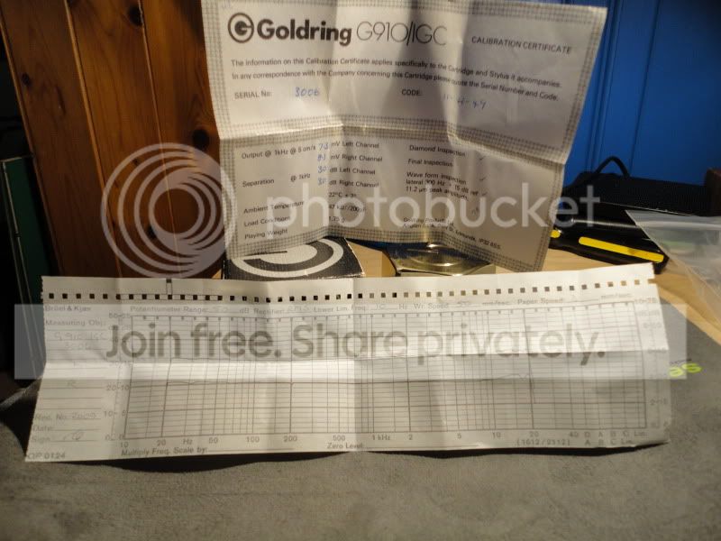

Each 900/910 was supplied with a response trace and calibration certificate.
The trace here shows +/- 1db limits 20Hz-20kHz - not bad for a cartridge!

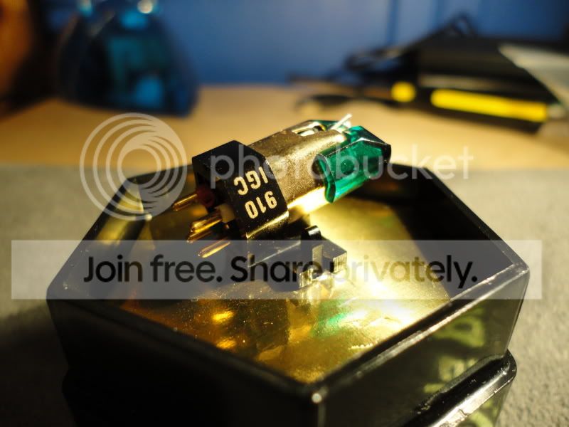

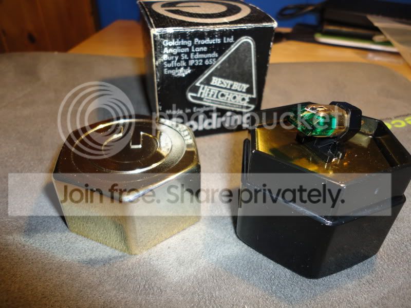

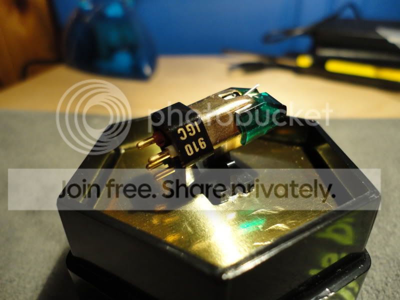

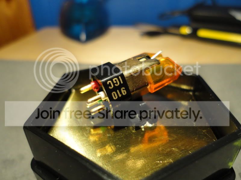

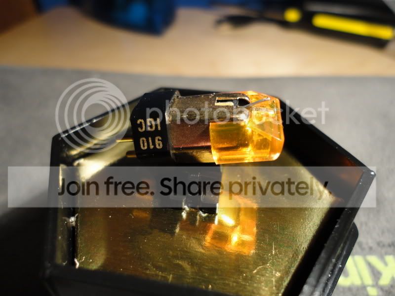

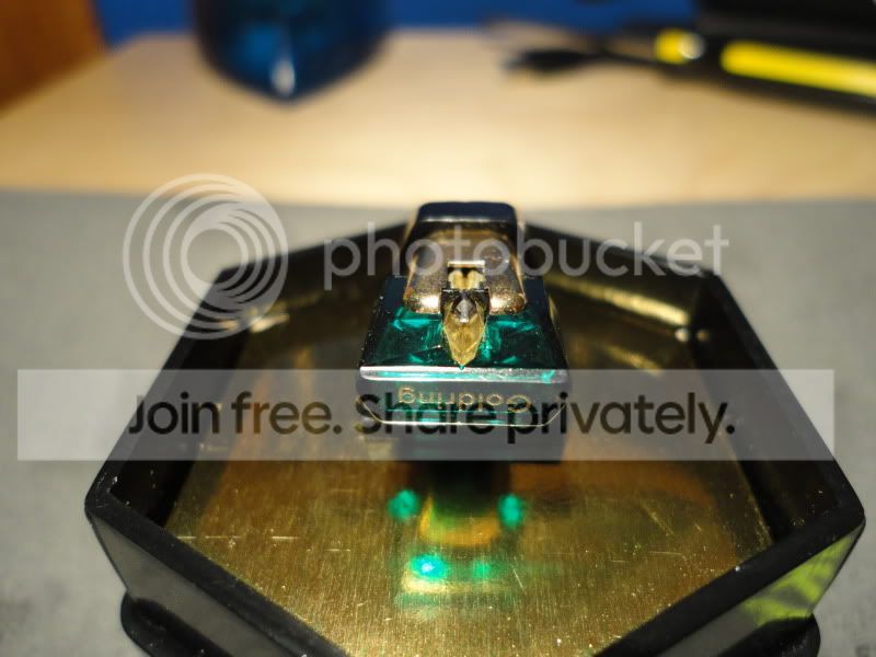

So are they beautiful?
Well, I think these are some of prettiest cartridges produced, particularly the black, gold and racing green combo of the 900IGC. The cartridge looks and feels tiny in the flesh.
Judge for yourself form the pics below.

Any pictures next to the AT for size comparison? Looks like it hangs quite low?
Why does it have that plastic thing on the front, beside style?

I've got a Dynavector Ruby with a frequency response plot that is at least as flat as that - It's still one of the blandest cartridges I have heard. Some may choose to interpret this as neutrality, but how can it be neutral if every recording sounds like the musicians are just going through the motions?
Because a flat FR is only part of the story, as you well know Mark :)
A flat response must surely be desired though if you want true fidelity to what is on the disc. Any deviation has to be inaccuracy, even if you like the result.
Well one would have thought so, it seems logical. However, my ears tell me differently and ultimately that is what has to listen to everything - as you say, a flat FR is only part of the story.
But what is on the disc? And which disc? Number 1 running off the stamper? Or number 4293?
A cartridge with a flat FR is likely to sound dull with the average commercial record, as the latter has gone through a process that only loses treble and detail.
As for fidelity: ever read 'Perfecting Sound Forever'?
