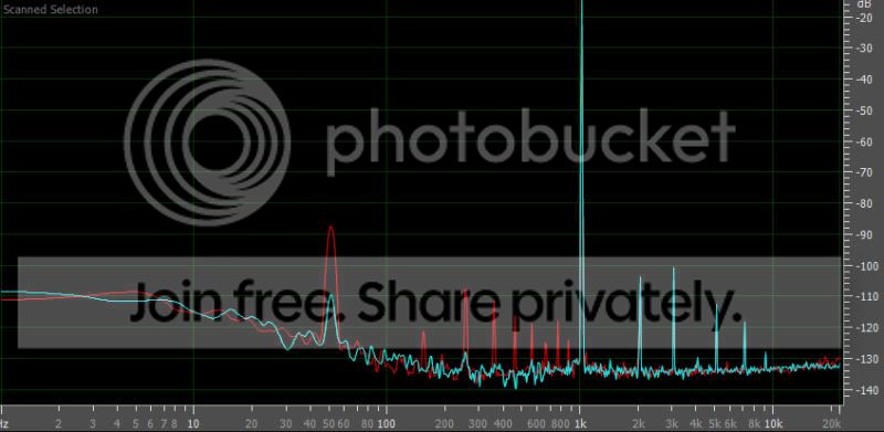

Today I was doing some routine measurements to make sure a bit of kit is working as it should with single-ended outputs.
Shock-horror it isn't working right! :eek: It looks like a serious grounding issue... oh dear. See the red trace in the graph below.

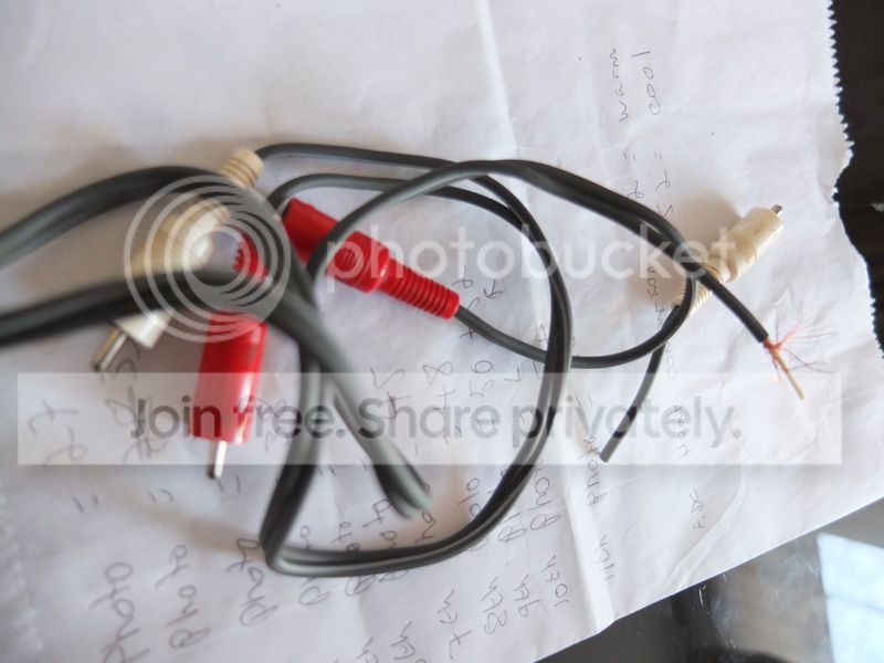

After lots of faffing about I found the noise was there even with the source equipment powered off. Eventually I tried switching out a cable (I just needed one with another connector) and the noise disappeared! :D
This is the first time I've EVER found a cable make so much difference. The result - cable in the bin. I don't know what is the problem with it because it has a copper twisted screen and a normal looking centre conductor. It's a phono cable that came with a JVC KD-720 tape machine in the 1970's.
Switching out this cable for a bit of Belden wire gave the blue trace.
40 years old thin cable. Likely a break in the screen/return at some point increasing the impedance to ground, or it's just very poorly/thinly screened - given the mains bump.
Still going to be inaudible though with a fundamental at -90dB and harmonics at -110db ;)
