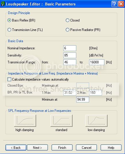

I have a couple of CARA questions for any of the regular users on here, they are pretty basic.
In the loudspeaker editor I have the lowest impedance figure for my speakers (Revel M22), which is 4.8 Ohm @ 160Hz. Yet when I type this into the 'Minimum At' box the value then defaults to the Max 2. box when I click 'next', as shown below:
Am I fundamentally misunderstanding something very basic here?

I don't think so, at least not intentionally. I type the 160Hz figure into the min box and then it defaults to the 'Max 2' Box.
No error message pops up, with those figures shown above it just seems to be that it won't accept the 160Hz figure as the min impedance. I was just wondering if this was some kind of impossibility or if it was just a glitch?

Mmm, have tried it, seems to be a glitch.
That said, if you type new values into the impedance and sensitivity boxes, and uncheck 'calculate impedance values automatically' it does seem you can type what you want into the '1max', '2max' and 'minimum at' boxes. Hit 'next' and these values should stick.
Don't sweat it either way - these parameters have very, very little effect on the final room response compared with positioning!
