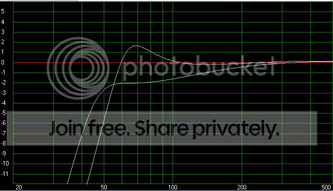

I'd agree with the above. I've had both the Quads and the Missions (in earlier guise) and preferred the Missions. They had more about them tonally, were smoother in the treble and as for the imaging....as good as it gets. Good choice of drivers and decent crossover. Front porting let them down a bit as with many small "choked" designs it does have a bit of an 80Hz hump (one note) but many of that size do.
That is often a case of needing to be tuned a bit lower. You can help that by extending the port a few cm with a pack of straws or using some open foam to damp it.
It can be, but it also depends upon the driver Qts and system Qtc, plus Vas figures. If the cabinet is already "optimal" for the drivers selected, then dropping the tuning point won't necessarily generate cleaner deeper bass and the hump in response may still be there. The limit can be dropped a little but shouldn't be dropped anywhere too close to the driver resonance point or driver/amp damage can occur. Damping the port changes the system Qtc (damping) and response. Tbh, such designs can rarely be significantly improved upon...it's the nature of the design and cabinet size.
I think it is very uncommon that the bass hump is due to driver fs and qts being high, rather than the port tuning simply being a little high. It's not really about the cabinet being optimal IME, it's just a choice by the designer in the tuning of the system, neither is right or wrong.
Here is an example of the Kensai. It is tuned as the lower curve which has less bass output but goes lower. Many small speakers will choose the other option which is exactly the same cabinet size and driver but tuned higher. It will sound like a bigger speaker at first but will kick off room modes more due to the peaking bass and won't like being close to walls or corners.
