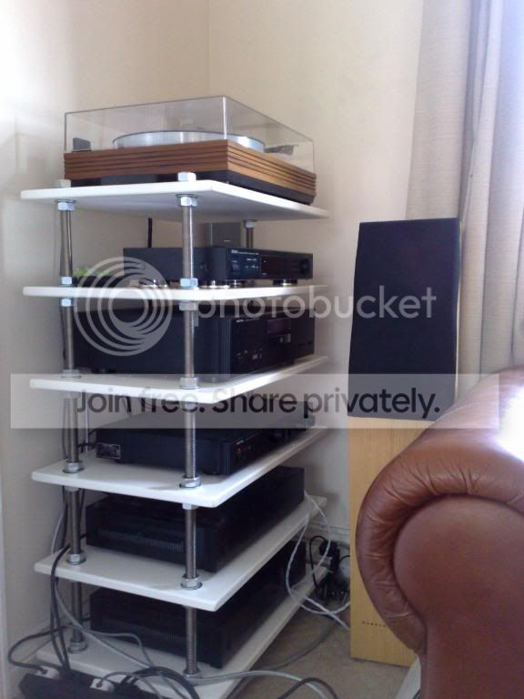

Folks.
I am currently building a Flexi rack, utilising stainless steel rod x3 (M20 with one end of each turned into a spike), 6 mdf shelves (20mm thick), 36 m20 nuts and 36 rubber (hand cut) and 36 steel washers.
I am going to paint to match the living room and then re-site my kit.
Is it worthwhile painting the underside of each shelf with damping paint or is that just overkill.
Pics to follow.
regards
John

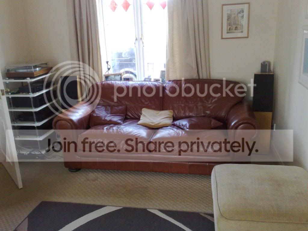

SUCCESS! Thanks for your help.
Please note, i am going to tidy up the power cables. I made them fit the previous installation and now they dont reach.
John

Success indeed!
Well done that man.
The rack looks great....how does it sound...?
ie the sonics with everthing on it?
DAVIDF.
Thanks for all your help.
It is hard to say if it has improved really as i changed my speaker cable (my own solid silver cable whose design i have changed) due to the different distance between the old and new setup.
What i can say is this. The sound is 10 times better than it was with my old set up. my old set up consisted of an enclosed, glass fronted cabinet with all my boxes in it. If i tuned the system up reasonably loud, the pressure waves caused by the speakers (which were situated either side of the cabinet) could cause the CD player to skip. If you put your hand in the cabinet you could feel why!!!!!!
The new rack is absolutely rock solid and very, very heavy. There appears to be absolutely no vibration in the rack whatsoever no matter the volume level. The bass from CD is now in a different league altogether, but perhaps the gratest difference is when using my LP12. I initially put on the killers new album on LP and whilst it sounded better, it was not startling, however i then put on Book of dreams by Steve MILLER and WOW. Sounded like a completely different package, and this with a BASIK LVX arm!!
In sum, for a relatively modest sum (i had most of the MDF in the garage) i have made a piece of hi-fi furniture that i am delighted with. It is very rigid (partly due to the number of shelves, partly to the 20mm stainless and partly due the the herculean effort i made in tightening the bolts) and i think looks great.
Best of all, it is a doddle to make and so easy to level. I can highly recommend.
John

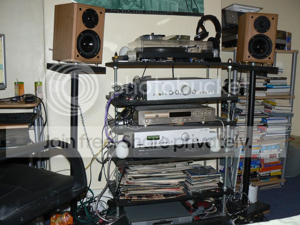

Hi, Nice rack, I made a much smaller version, (3 shelves) but it sounds better than the Atacama that I had. I kept my bolts fairly slack, so it's got some movement, hence "Flexy Rack" Similar to the Quadraspire principle. By the way, you really need to move that sofa!
Here is mine, I bought it about four years ago.
I really really really need to tidy it all up, the shelves have become a bit of a dumping ground.
