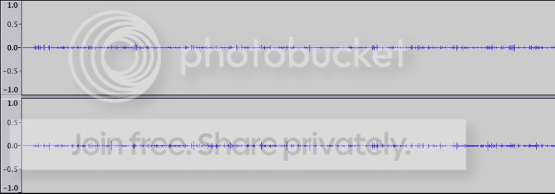

Here is an example of what you can expect:
Rega P9 on a Sound Organisation support spiked onto wooden floor at approx 1ft from the speaker, sound peaking at around 90db:

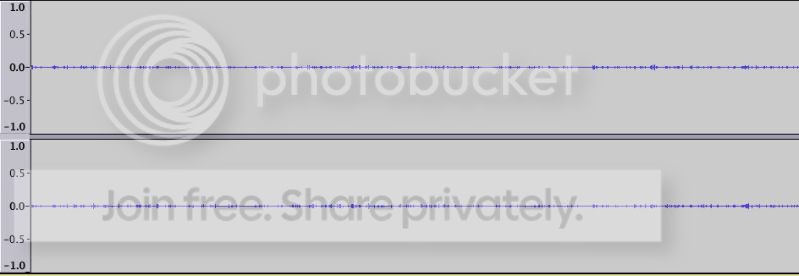

... and about 3m away to the side of the room.
