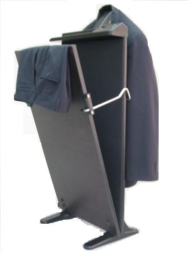

I wonder if my trouser press would work :)
...... actually, with a couple of thin sheets of glass it just might!

BTW I wouldn't have thought the trouserpress idea is a goer ;). As I understand it these record flatteners work well mainly because of the well controlled nature of the heating up, cooling down and temperature control. You want to take it to just the right temperature for the vinyl to relax enough to unwarp and no more and then slowly bring the temperature back down again (so I've been told anyway) ... presumably you need to ensure that the heat is evenly spread and that the surfaces are spotless, and the disc scrupulously clean as well. I know the Clearaudio version of this takes about 4 hours to do a disc.
..but you own a trouser press?!
Oh yes.
Actually I inherited the thing from an ex into all these home gadgets. On the odd occasions it gets used I usually fling the suit trousers into it after a late night out on the beer after work. I've had creases in some strange places as a result :D

The trouser press is an interesting idea.
