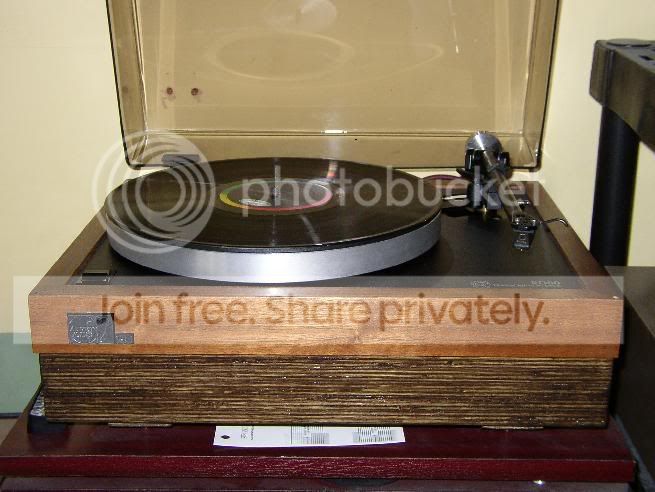

My obsession with modifying this poor thing started about a day after I bought it, about 4 years ago. It was a bog standard RD80SL with the evil tin plinth base of doom, and had the motor coupled directly to the plinth top plate. The motor caused some nasty vibrations/hum, so I set about isolating it with a sorbothane gasket (which worked very well indeed. I then added a very 'DIY' laminated plywood base on big stainless steel spikes.
A while later I was bored, so I made a new subchassis from 5mm ally plate and damped it with 3 rubber bungs. As a result the new subchassis was dead as the proverbial when knocked, and this seemed to improve the lowly RD80 quite significantly. At this time it was fitted with a modified RB250 (rewired and fitted with a nice new end stub and counterweight).
This all sat on an awful DIY shelf:
All was well until I moved out, and had the TT on top of my Hifi rack. This was fine in my first rented house as the floors were concrete. When we bought our new pad with suspended floors, the TT sat atop the rack giving a lacklustre interpretation of the music at best. It wasn't level, was severely susceptible to footfall, and became more of a place for the cats to sit than something to play DSOTM on late at night.

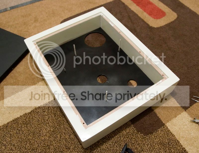

This shows the upturned plinth/top plate. The plinth is made from 2 pieces of laminated 18mm MDF, with machined rebates for the top plate and rabbeted joints on the sides/front/rear. The top plate is made from 5mm sheet aluminium. I did originally plan to make the top plate from a 2mm ally/silicone sheet/2mm ally lamination, but didn't have any 2mm thick ally to hand, so settled for a single 5mm plate instead. It is held to the plinth using 14 off M4 countersunk socket screws:

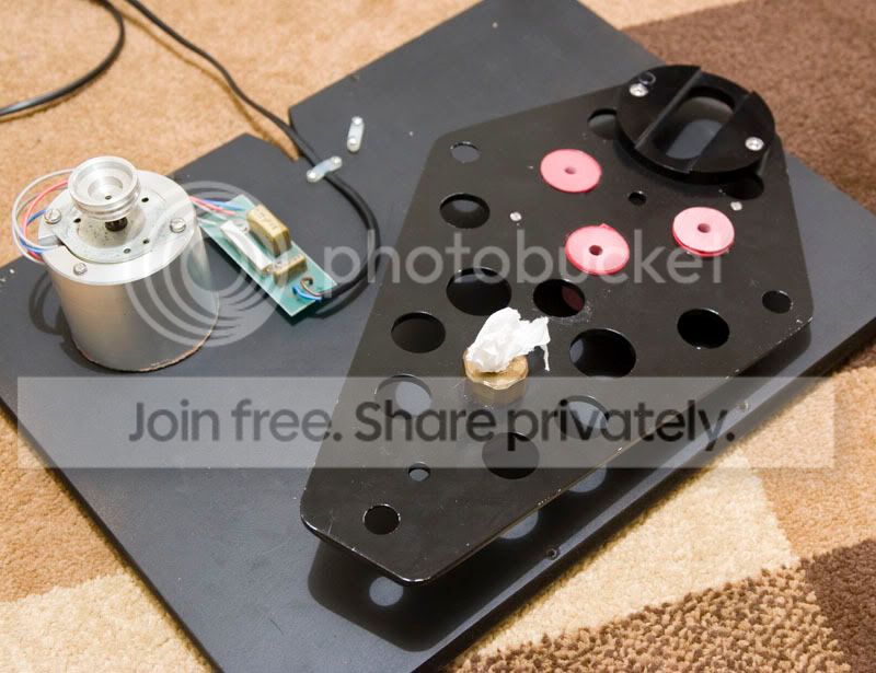

Here is the subchassis (as made for the RD80 when previously modded), atop the plinth base (18mm MDF)/motor pod assy:

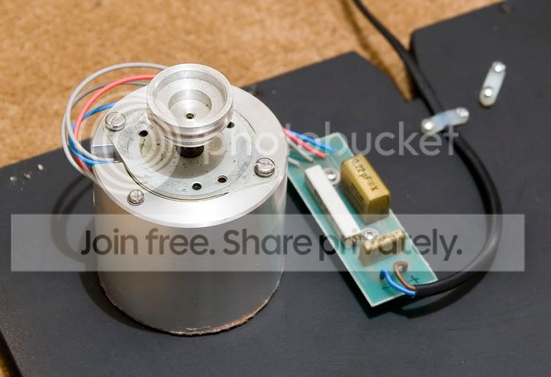

Here is the motor pod close up. I turned/milled it from 3" aluminium alloy, and has a cork gasket between it and the plinth base. The standard PSU is currently in service, but there are plans for something else in the future (DIY Geddon most likely):

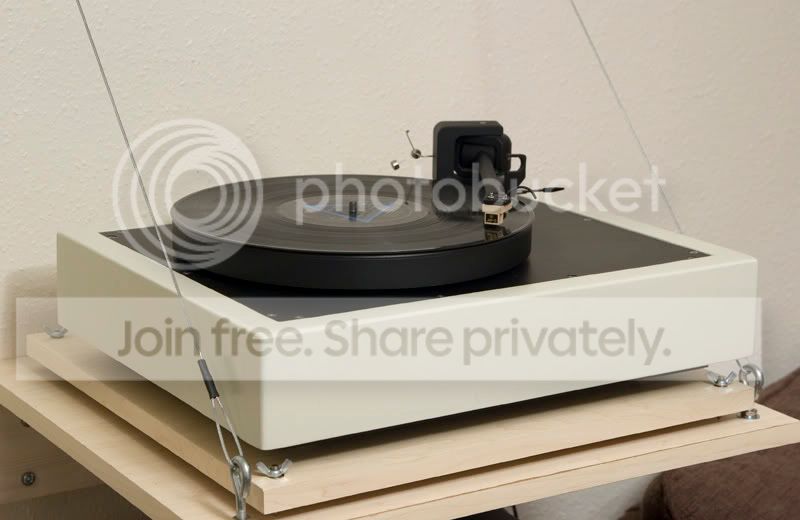

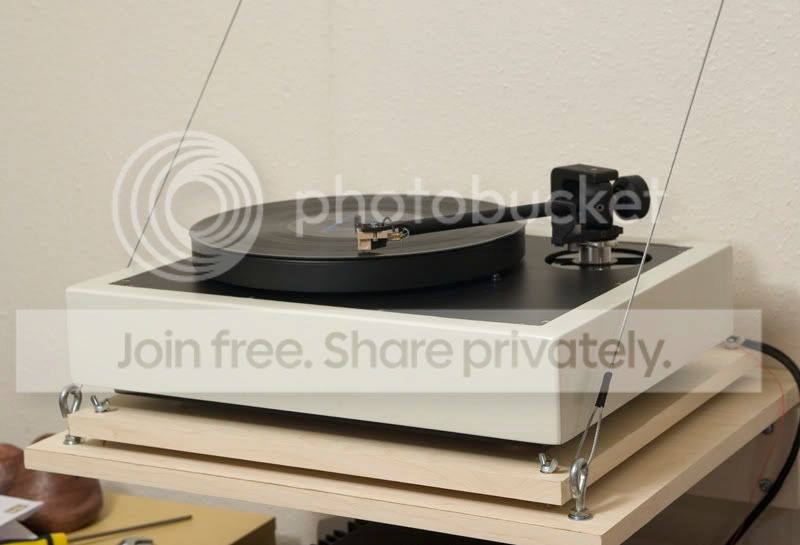

Here is the finished item. I'm dead chuffed with how it all came together, and that it actually works okay. Actually, scratch that - very well indeed:

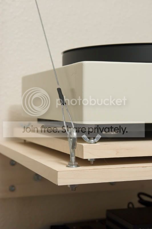

In the previous two photographs, you can see the shelf is mounted rather differently to most. It's suspended from the wall with 8mm shield anchor eyebolts and some cables I made up from 2mm steel dinghy mooring cable (breaking stain of 260kg!). I pre-tested a mocked up cable to 36kg, and it was fine although the solder hadn't run around the join properly (note that in order to solder steels, a special and somewhat evil acid based flux is required). The shelf is levelled using 8mm eyebolts at the front of the base section, and has further adjustment on the shelf 'plinth' section using some M6 spikes I turned up:

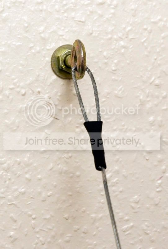

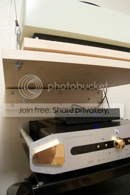

The last shot there shows how the shelf is attatched to the wall. There are two slightly flimsy brackets mounted on a pice of 2x4 in such a way as to allow the shelf to be raised and lowered at the front to allow levelling. It's very stable, and has passed the cat test (both of our cats being simultaneously plonked on from a height of 2 feet). The shelf and plinth section are made from 18mm MDF.
