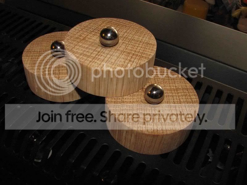

    This si the design I am working with, though I am now sinking the ball futher in to the cones.
    [​IMG]
    I use a router to make the holes, ideally a precise semi circle for the balls to sit in.
    IME the devil is the detail with this job!
    The cones I am turning myself, out of oak.
    The balls (now approx 16mil) are from a local supplier in Shrewsbury. (i can let you know hwo if you would like?)
    I might also add that they are improved for a coat of wax......it hardens the surface.....but they are still able to absorb vibs well.

    What a great piece of work - those things are beautiful! Great idea too. I work quite a bit with wood but don't do any turning - no gear or space to do it :(
    Solid oak? So at a guess, they're coming in at £30 - £40 for three? Is that right?
    My understanding is that the theory, such as it is, is that the bearings take vibration out of the equipment above - that's right, isn't it? I guess with yours, the bearing is free to move but 'captive'; the oak, very dense but with grain running away from the bearing surface could carry that vibration away?
    What equipment have you tried them on? Rollerblocks and the like have a reputation for being really good under some equipment, don't they? Especially if placed directly under a transformer, for example?
    I am guessing but looking at the other things in the picture, they seem to be about 3" diameter - is that right? Height with bearing around the same?
    I wonder what they performance would be like if they were reduced to half that size?

    Corky,
    Thanks for your kind comments! :)
    I was doing them for other forum members but I had to stop for a variety of reasons.
    I'll answer your post in point form, its just easier,
    1) Not sure on price if I was doing them. I guess you wouldn't be far out.
    2) The idae of the cones is that the oak absorbs the vibs (it is reputed for it as a marterial....its under my Dad's canal boat engine). As you say mechanical vibs are drained away from equip, through the cones and disspated away by the balls, which are free to vibrate in their holes.
    Vibrations absorbed by the equipment rack etc i.e. fed back to your kit are not transmitted through the ball upwards (or should I say the movement is minimised).
    So the ball cone idea seems to have a two fold function.
    AS you say the ball being captive is the key.
    The relationshiip between ball and cone (ie the cone surface) as you hinted at, is an important one! Carefully sanding that surface dead smooth has produced (IMO) astonishing results.
    3) I have tried them on principally my own kit +a few others(generally favourable comments I think!)
    At xmas I tried them on my brothers Musical Fidelity x ray v/ x 10 (?) and Spendor combo.
    My bothers is NOT a tweaker (and I had to twist his arm a bit! :eek: :D)) but even he had to agree it certainly sounded no worse! I am cetain they expanded the sound satge.
    4) No, I haven't tried roller blocks.
    5) Size wise they (in the pic) proabably are the size you say. IME the bigger the better!
    Dare I say it they sound better still with a small amount of balsa wood included :cool:! (another favouite marterial)
    The ones I am using are I think nearer 5"!
    6) Half the size?
    YOu get half the benefit!!
    7) I would also say that the BB size (IMO) has a major impact on final sonics.....but thats another subject entirely........
    DavidF, Apr 20, 2008

    As a setup for multiple pieces of pre set size, I imagined a jig to hold the work safely: ply box open at the end and work piece held with a wedge or two.
    having cut three, a second jig with three bays and a base plate the put them all level at the bottom then cut through all three one after the other for definite same size. Could be done one at a time.
    A guide jig for the saw would be helpful - especially if the cones were going to be cut to final length one at a time.
    btw, the dealership I went to today ran his business from his home. The shelf system in his dem room was four substantial pieces of ply as shelves, suspended one below the other on pretty thin stainless steel and the top one fixed to two pretty substantial steel brackets on the wall. His five grand vinyl spinner was sitting on the top shelf on a standard home made sand box...
    Corky, Apr 21, 2008

    I have in the past mentioned jigs .....
    as with me dave is on a tight budget so I'd expect new gear would be a luxury thats just out of reach....
    dave used a sandbox in the same way I did ....under the whole of the stand .....I found this effective greatly cutting down vibration from floor to rack [20% but mainly higher freqs].
    I had some good results suspending shelves but it looked very bad on the flexy [which dave now has]..also floating one shelf off another with sorbthane puck worked well ....
    zanash, Apr 22, 2008
