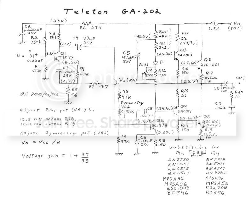

i`m new to this i need some help with a teleton ga 202 the output stage is shot and i am having trouble trying to get replacement power transistors c1060(all four) if i remember a darlington arrangment.i`m sure a modern general purpouse off the shelf power transistor would do case To220.

Didn't think I had this but just found it:
GREAT Thank you robert,
if i remember would it be wise to change all four transistors in each o/p stage as its directly coupled?
i am sure TIP 41c will do the job for asc1061 the others look very familier

Please check this out before installing but I think you can substitute a TIP 41C for the 1060.

The amp has a capacitor coupled output so while you have it dismantled it might be wise to replace the output caps. These have improved massively in 30+ years. 64v 2200uf or even 3300uf should now fit the board.
C8 on the above schematic.

yes already thought of this, i can get them from maplin although there axial types i can still do a neat job. as you say i have to remove them anyway to get at the o/p transisters.i shall complete the repair this week so keep fingers crossed.

changed all drivers and o/p tr`s o/p, coupling caps applied h/sink compound to all tr`s removed flux from pcb(still have some real solder).
switched on: increased volume:distorted both channels:left hand channel very low(suspect origianl faulty channel):just about to cheack bias voltage then FIZZZZZ smoke left hand pnp(q4) fried.
i`m not going to investigate any further. although i enjoyed the challange i do not have the test gear or workspace anymore and it was very dificult to get the correct bits.
