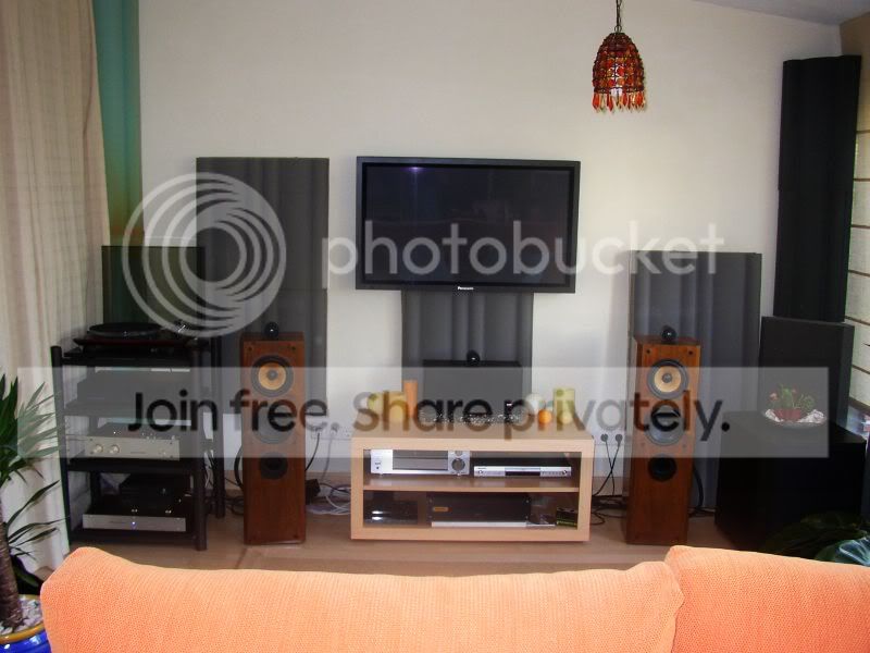

I took this rather blurry shot this morning,it's a arrangement I came up with last night,the foams are procorner,and profoams,I'm waiting to finish them of with fabric covering.I've hung the one on the left,and have left an air space behind it,I made it 3 foams thick,I need to hang still the one on the right,then to finish it off,just cover them.I have some smaller procorners on the rear wall and some melamine foam too.
With this set up,I'm getting some superb sounds,the room sounds much deader,but doesn't kill the music,bass is under much better control,more defined,treble is sweetend too,I can't believe the difference the products has made to the room,a worthwhile investment,a great product and great service too.

Look good Adam! How deep is the stuff (inc. air gap) on the back wall? I can't help feeling you would get a greater improvement from putting at least one layer of that stuff on the ceiling at reflection points.
Do you have foam in the rear corners too, or just that one in the right?

I hope it will look even better when the CARA fabric arrives,it's been a headache as in not DIY best friend so alot of sweating & swearing has taken place,to make them (good glue)and hanging them.
I've just followed Matts advice and my own thoughts,so I've left a air space of 2cm,I've made 2,one is 8cm deep = 10CM total,the other is 10cm + 2cm air gap=12cm.I've used MDF then rockwall,the the RPG profoam,I've gone for depth more than area coverage as it sounded a bit dead using the whole wall.
It looks like thier is only bass trap in the pic (right hand side)but if you look on the left,you'll see a sky blue type colour,that's also a RPG bass trap,I bought some old ones to save some monies.I have one small one in the rear corner to one side.
First reflections were a pain,as both side were glass windows,so I made another two absorbers,same design,a MDF board so it could rest against the glass,rockwall,then profoam,not quite finished yet.
I guess I need to do the ceiling at some stage,where do you put it? above the speakers or above the listening area?I think I would need something,thin and white,and not covering a large area,it's not my living room,but a room I had built so I could dedicate it to listening to music,and watchinfg films,but still want it to look nice without the studio look!!.
I had it set up last night as in the photo,put on my Rega,and it really had no right to sound the good,it was worth the hassle and help.
The ceiling should have treatment at the first reflection points as well. If you sit in your listening chair and get someone to hold a mirror on the ceiling (quite hard I know!) then where you can see the speakers in the reflection is the first reflection point.
Depending on the room they are generally a few feet in from the speakers (toward the centre of the speakers) and about half way forward between the front of the speakers and where you listen from.
