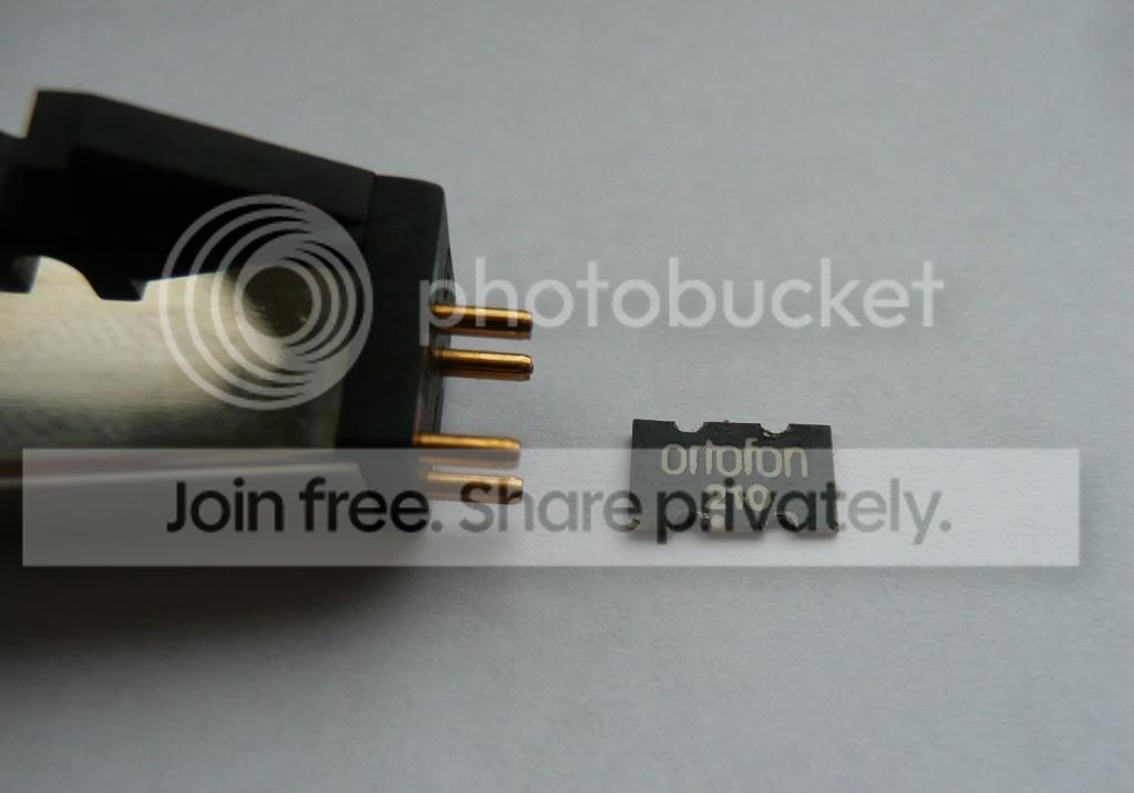

Ah here you go. Looks a bit daft but works!
I'd forgotten that my M20FL Super had the optional CAP 210 attachment fitted.
This little widget fits between the pins on the back of the cartridge and as the name suggests it adds 210pF of capacitance.
I believe 400pF total capacitance is optimal for both cartridges. My Trichord Dino is set to100pF. I've no idea what the capacitance of the interconnects etc adds up to.
Out of curiosity I removed the CAP 210 and hey presto the M20 FL Super now sounds very similar to the VMS 30 mk2.

Ah the pesky little CAP210 which lurks on the pins of many a VMS. That would influence things for sure.
