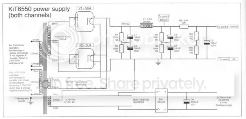

Chris, something else to check would be the condition of caps C1 & C2 that sit in the HT supply. These take a hammering in that particular circuit due to he high ripple from the 5U4G rectifiers and can start to hum after a couple of years.
C3 & C4 can also be replaced but come after the choke so benefit from lower ripple on the line, and last a good bit longer.
Gets hot inside that amp which doesn't help cap life either.
My humming 6550 fell near silent with a couple of Mundorf caps in there.

No problem - but start with C1&2 first as that is very likely the problem:

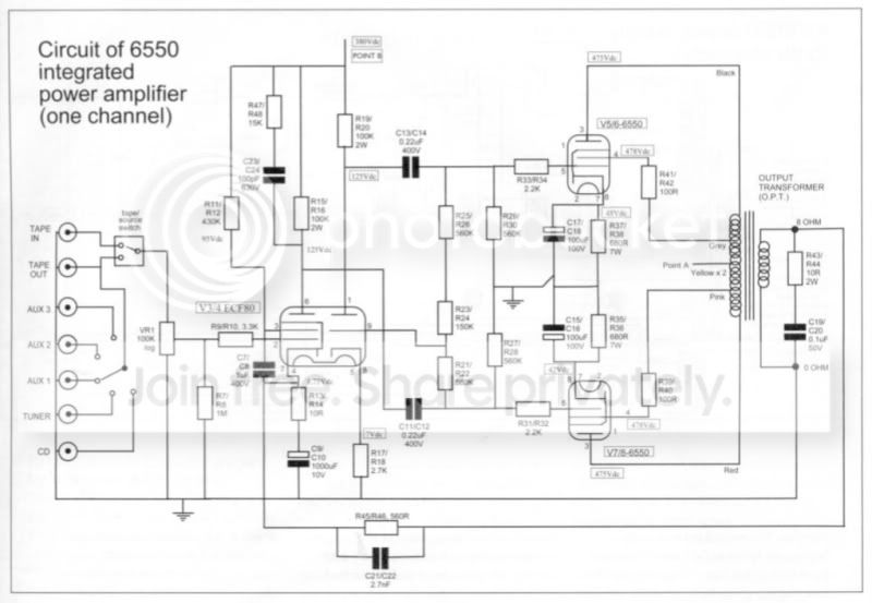

Schematics:
PSU:
Channel:

The choke can buzz and get quite noisy but this is also a symptom that C1 & C2 are failing. Those caps form the initial filter before the choke smoothing, so if they deteriorate you get more ripple going through the choke, and it vibrates.
