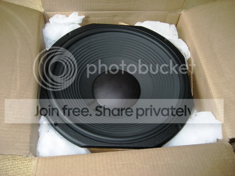

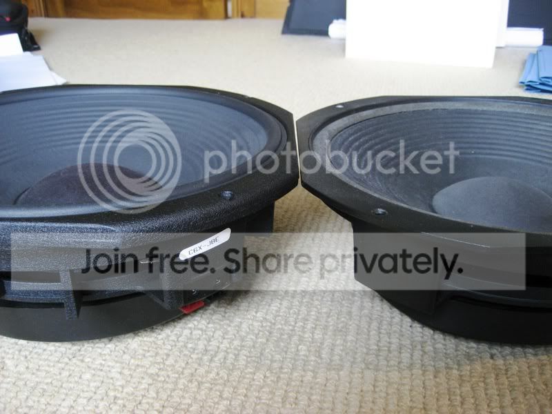

You have to be very careful to line up the lead out wires with the frame terminals and also to get an even and smooth spread of glue around the frame/surround.
After checking there's no fouling of the vc leave over night to fix. The scariest bit is gluing the dome as it's so easy to get glue all over the place and also to place it off centre-I made a lining up jig from masking tape so Bob's your aunty job done.
The cost of these recone kits is such, shocking european prices, that I'd recommend using a JBL service centre as JBL will not guarantee the kits unless professionally installed and it is easy to cock it up.
