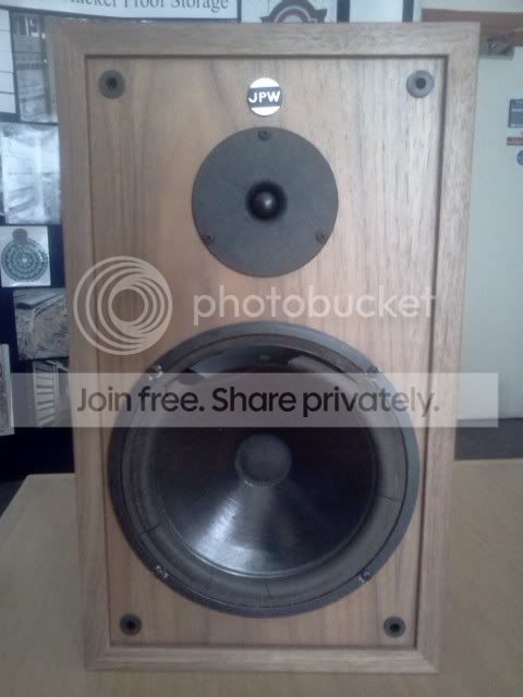

Old JPW's
Got these new in 1986, but they've been sitting in the loft for 20 years. Just ordered a foam kit to repair them.
A very decent cheap speaker from what I remember of them, and at the time, beautifully made.
It's worth replacing the electrolytic tweeter feed cap (4.7uF) with something better ie a polypropylene type. Not sure whether the above are P1's or AP2's but the main difference with the AP2's was the addition of some bituminous sheets on the insides of the cabinet to damp panel resonances a little. Something like Dedshete.
Re the AP3's, the above cap mod applies there too. I also feel the AP3 benefits from a little more wadding than was in it as standard, ie perhaps half as much again or even double the amount.

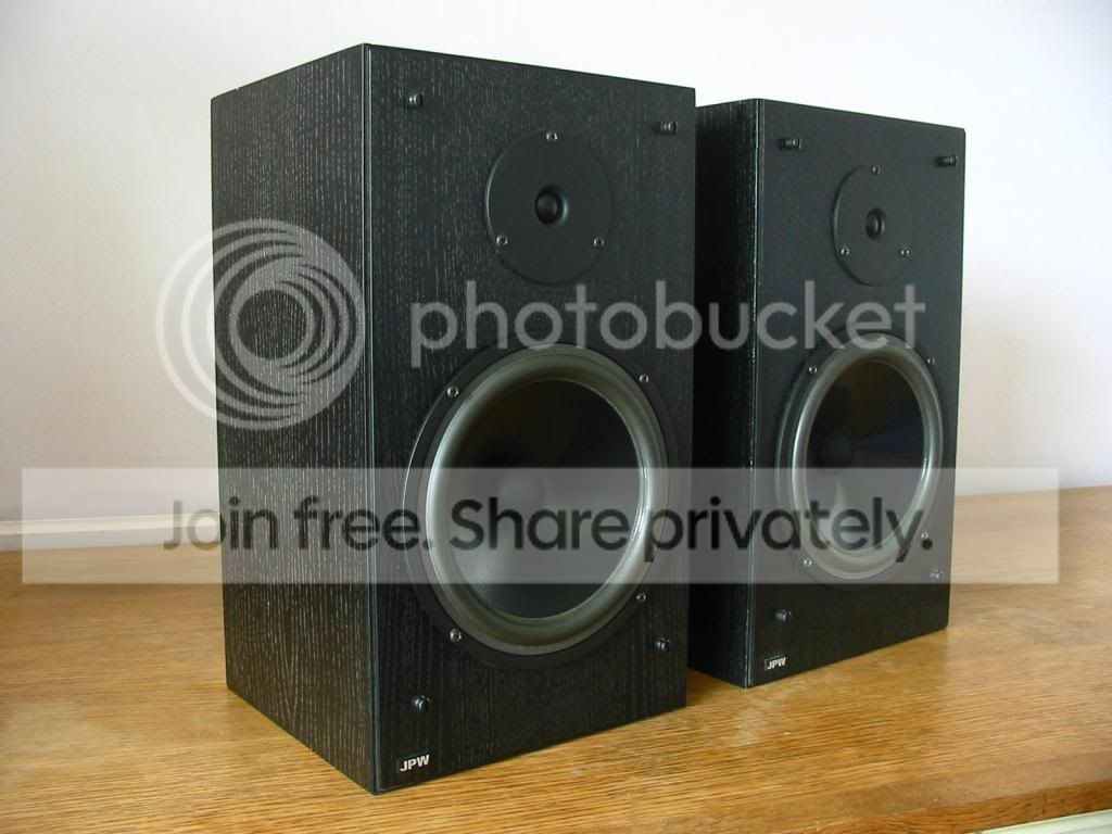

Mine are in pristine condition. Either had they been refoamed or they were NOS. Not a single mark on them. They even come with some funny labels: "British at its best". Well, I agree :D
Front:
Uploaded with ImageShack.us
