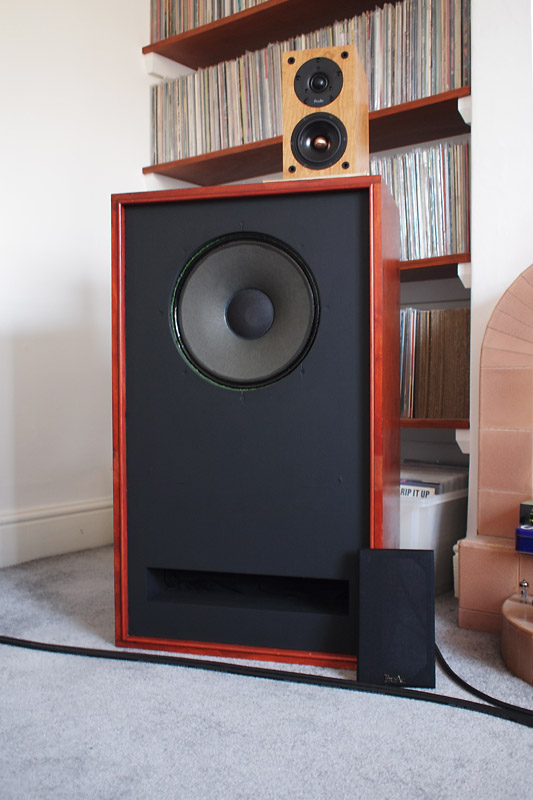

I've recently gone from some extremely small speakers back to extremely big speakers:
The little ProAcs have very wide dispersion and very good driver integration in the conventional sense. The Tannoys are directional, they beam, but to my ears the treble is *much* better and more realistic - cymbals have a real weight and reality to them, there is a real sense of stick hitting metal and you can make a very good guess as to whether the drumsticks have wood or plastic tips. Acoustic space comes through very naturally too. A very clean clear treble, and it represents much that I missed when I mistakenly reverted to Harbeths recently. I just like the way horns do treble more than conventional tweeters.
Paul W Klipsch, one of the most intelligent and inventive audio pioneers IMO, always considered controlled dispersion to be a huge, huge advantage. He built his speakers with exceptional degrees of common sense; he realised that rooms tend to have walls and corners, so better to factor them into the design than fight them, and he realised that the human ear is far better at filtering out late room reflections, so controlling the dispersion - firing the mid and treble directly at the listener - means they get it well ahead of the room reflection. Result: perceptively far cleaner and clearer treble. After living with both Klipsch and Tannoy speakers for several years now I think I've come to the conclusion that I couldn't return to the conventional wide splatter-gun approach to treble. Horns just give a cleaner and more intimate top end IME. The treble from horns reminds me of very good headphones, it has that real clarity and lack of splash.
Tony.
PS As I'm sure Rob will testify my room is well damped and very natural sounding with no obvious reflections / echos / booms etc beyond a very slight rear-wall bass lift (smooth and non-boomy), i.e. I've not come to this conclusion to compensate for a bad room, quite the reverse, it's one of the best rooms I've ever heard a system in.
