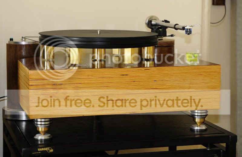

My first hi-fi diy job
Yet to finish it but getting there
It has a michell inverted brass bearing - Michell platter and DC motor - RB250 rewired with silver single run loom - Isokinetik end stub and weight
I have isolated the arm board from the table with O rings then the arm from the arm board with O rings + O rings on the arm lift and tube to dampen them. The motor housing is filled with sand then damped with 2 O rings.
Cartridge is a Denon DL 160 phono stage is a Cambridge 640p although i have just bought a Black Cube SE (waiting on delivery)
Anyone local to me want a listen and cast an opinion give me a shout
Chris

DIY Turntable
Hi Chris very nice job, would love to have a listen but im up in deepest darkest Yorkshire. I would like to ask if I may, where did you get the motor and bearing from. I am also considering doing a turntable build and any info on procuring good materials would be appreciated.
Best Regards
Dave
Hi Dave
Thanks :-)
I got the motor and bearing from http://www.analogueseduction.net/ http://www.analogueseduction.net/
They offer very good service and keep you upto date on orders. I did consider the Ebay standalone motors at 80quid but read some 50/50 reviews so thought at least the michell DC has an upgrade path and is of high quality to start with.
The plater i got from ebay 80 quid used. Birch ply from ebay from the hobbies shop as its good quality 9mm
Hope that helps some
Chris

Hi Dave
Na i'm not experienced enough to review it but anyone who wants to can :-) It sounds good to me a definite improvement over my Pro-ject Xperience deck
