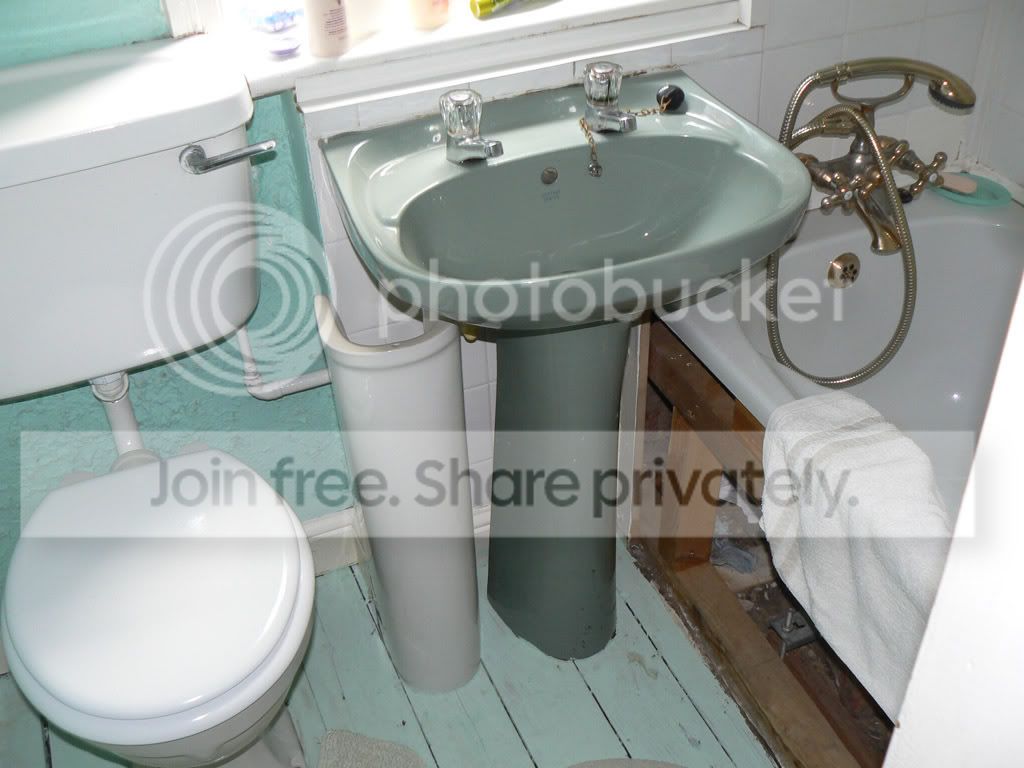

OK I have never done any real plumbing in my life before, but all my mates warned me of this project, but me being me I believe you only get confident doing DIY projects if you actually do more complex stuff than changing a light switch.
So I have spent much of the day doing this, I still need to sort out the drainage but that is for tomorrow (the existing plumbing dosn't fit as the new sink is much larger) any some pics taken on my Panasonic FZ7 bridge camera. Sorry about the blury one, forgot to use the flash!
Some pictures of the project (I forgot to use the flash on a couple so apologies).
This is the old sink

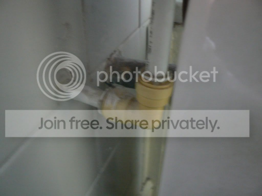

The old plumbing

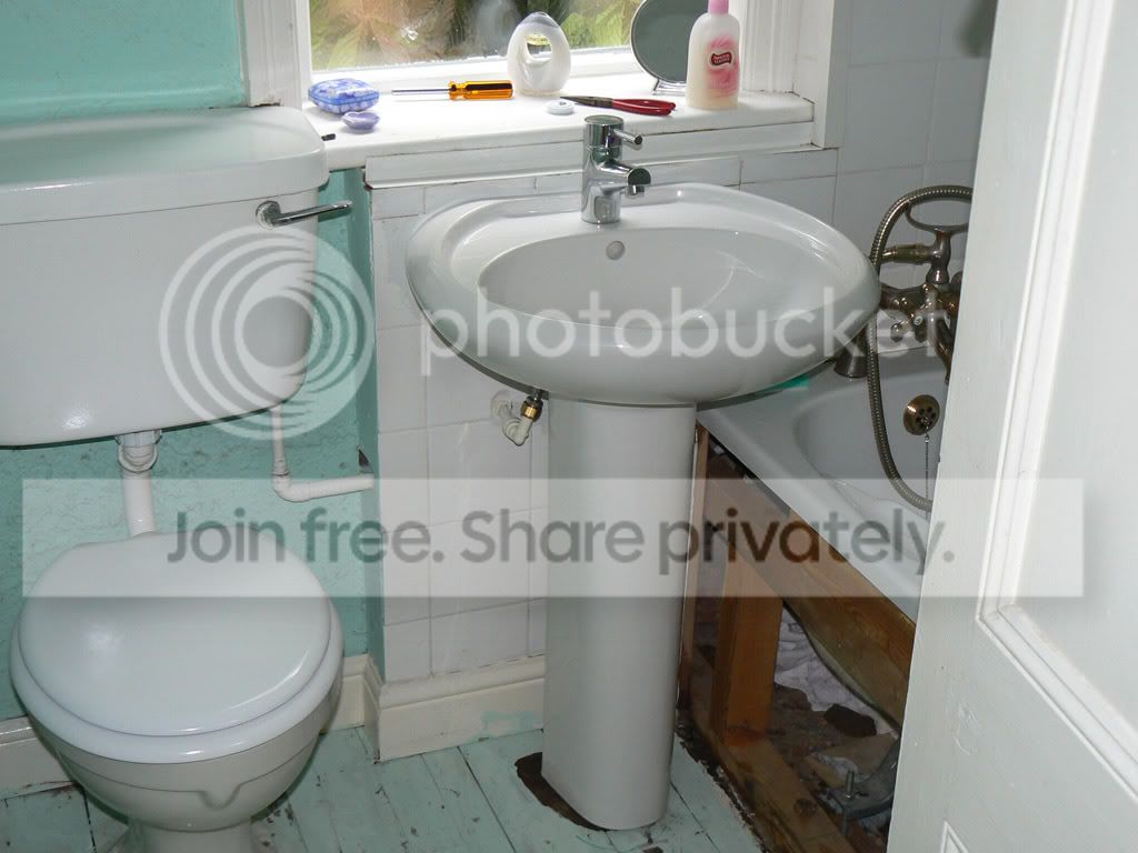

The new sink in place

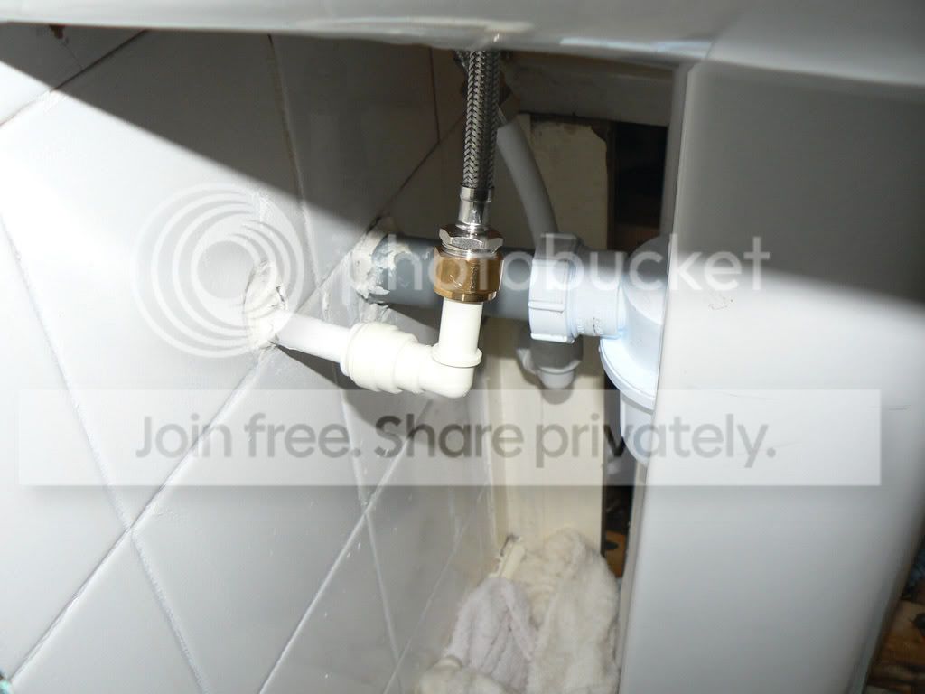

The new plumbing in place
I don't think I have done badly since the only plumbing I have done in the past is connect a washing machine and replace the cold water tank inlet valve.
The floorboard paint is only temporary until we replace it, the entire bathroom is in pieces atm!
I will replace the cistern handle but I will have to leave the bath taps alone, I am even going to attempt that! The cistern was actually the same colour as the old sink but my mum has done a good job of painting it with tile paint.
There has been lots of leaks during the day, but hopefully they are all sorted now.
Yeah done this afternoon, it was a bit tricky as it was all in the wrong place, but a 32mm bottle trap height adjuster sorted it :).
It is one of these jobs which could be done in a quarter of the time next time.

From what I've seen the trick to stopping leaks and making a good seal (by people who've fixed my cock ups!) is to use plenty of PTFE tape, when that's been done it should be solid.
Yep it is really quick tricky trying to get the olives to form a water night seal. The push fit connectors are also a little bit difficult as they snap the pipe in straight away, regardless if the pipe is funny inserted, so you have to be really quick and force the pipe in as you push the connector to it.
I ended up using puh fit connectors all round, as I didn't trust my olives. One problem is when you cut the pipes they have to be completly straight or the push fit connectors won't seal it water tight.
The drainage was quite difficult as all inthe wrong place and I had to work behind the pedestal but spending a bit of time on B&Q's website to look at the various connectors made that job much easier.

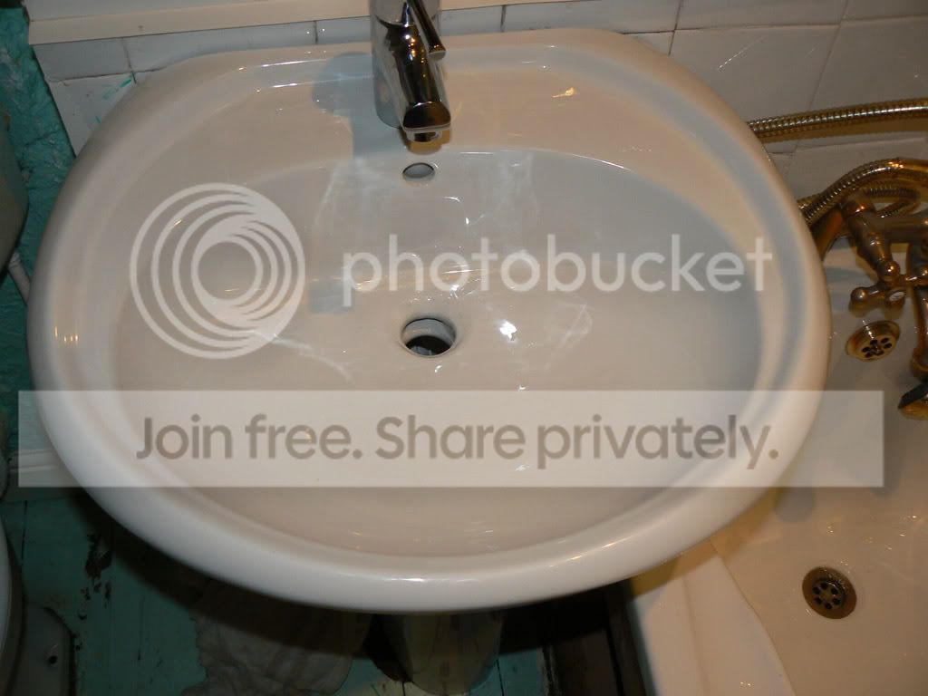

This is the picture of the sink funnily in place and with sealent round the back to stop any water falling behind it.
