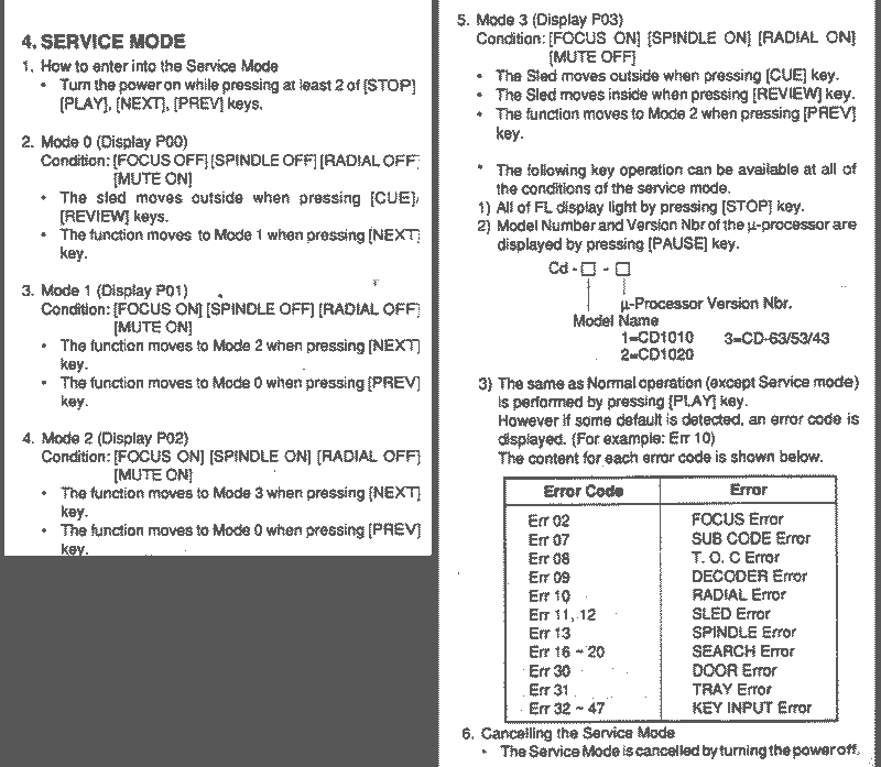

If you want to diagnose CD63 transport errors here's the full service manual procedure: turn the player off, then back on holding-down the 'Stop' and 'Play' buttons; then step through this procedure:
If you get Error 2 a lot - then replacing the laser mech is dead easy. It's a VAM1201J or equivalent you need, about £20 from Dalbani.co.uk or others, and the procedure is the same as this:
