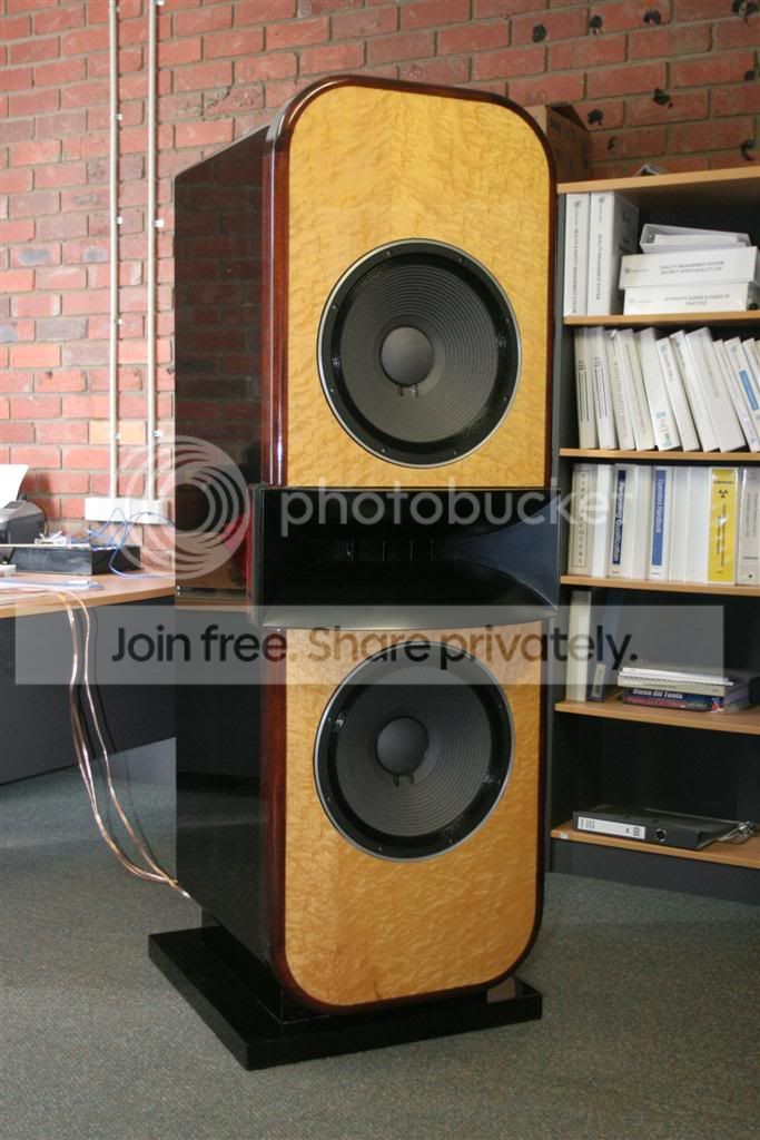

Some people have expressed an interest, so here is some info on my new setup.
Here are my new speakers. They use a Tad 1601a, Tad 4002 on a JBL 2397 horn, JBL 2405.
Some system changes.
I now use a Crown K1 on the bass, Glasshouse 300b on the midrange horn, and a chinese EL84 amp on the tweeter. I am using an Ashly active crossover.
A pic.
Cheers
Chris

How did you settle on your crossover settings? Did you do any measurement or just tweaked by ear?
Hi Tenson
The Lansing Heritage site is full of people who have built TAD and JBL 2 and 3 way's a lot like mine, mostly in the U.S. of course
I got a lot of help from a small number of really knowledgable TAD/JBL folk on there. I really owe one of them a debt in particular.
Anyway, the crossover points where something I knew before I really began. I thought I'd have to tweak by ear, but I put them where I'd been told to, and moving away from them didn't sound better. I then just adjusted level, and the Ashly lets you EQ a little around the crossover point without changing the overall slope - (more details here **) - so I played with this control by ear.
Basically, about an hour or two of mucking about had it licked.
Funnily, a variance in level between channels (which I blamed on the crossover) was actually some ageing valves in the pre-amp ! Changed these today and back to normal.
A harsh lesson about jumping to conclusions for me there..
response curve adjustment**
http://www.ashly.com/manuals/xr-manual-n.pdf
Hi Keith
Thanks :)
I got a friend on Lansing to work out the volume, Wilmslow helped with the cab design and parts ( I was struggling to get the dimensions to give the right volume with an angled front baffle). I then drew and modelled it somewhat, and then a local carpenter made the final design for me.
I DID however put the drive units in, AND attach the wires to the back :D
my neighbours must love me... I keep playing music til 1:30 am or so at volume...

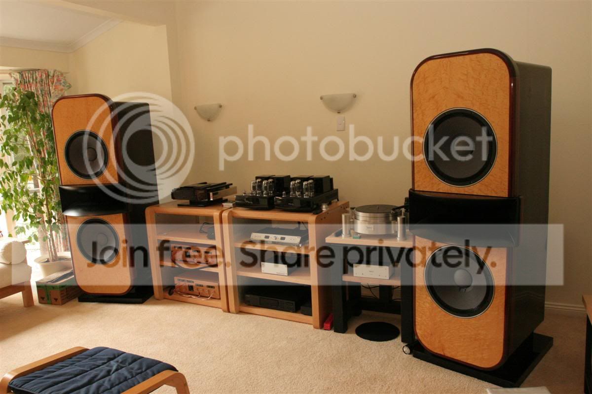

Nice work Bottleneck from another recent TAD DIY'er. My system is a 2 way using dual 1601a and 4001 on clone Maple 4001 horns. l grappled with active vs passive but went for passive for now, l am impressed to see you got that side of the design done so quickly and satisfactorily activley. Did you use any Eq on the horn or was it pretty smooth without any filtering? Do you have a link to any info on the Crossover you used? l was close to going with a Marchand XM44.

Here's a couple of pics. Thanks for the crossover info, l will see what l can find out about it, ideally l need to be able to put a small time delay on the woofers and the ability to filter the 4001 a little, but haven't measured my TAD passive crossover clones to know yet exactly what l need
Cheers,
Mondie

Hi Chris,
l definitely will integrate a super tweeter in the future. l would like a pair of ET703s, l can make up a simple bracket and hang the off the side of the baffle and if l like the improvement, then drill holes in the baffles and mount them properly. Time alignment would be non existant but most seem to think its not a real consideration. probably the reason l havent done this is because l love the way they sound now, and of coarse the crossover. To do it properly l need to cross to the 703 but also roll off the 4001. This would probably be difficult passivley using the passive crossovers l have now so l will probably hold off until l have switched to active and got that side sorted first.
Since l took these pics l have sold of the Melody KT88 valve amp and are driving them with some ballsy 200wpc Xindak Monoblocks, beautiful amps that really deliver the drive and grip the big cones need. The bass is just unbelievable, only big cones can do really bass IMO and these TAD's demonstrate this beautifully.
Thanks for the offer of help, l will do some reading on the Altec forum on these crossovers, they could be a cheap but effective way to play with active.
