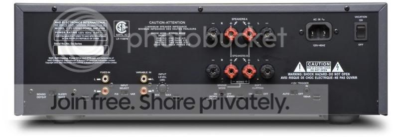

The NAD has a variable input so you effectively already have a passive 'pre' built in.
Check the manual to be sure that the control will allow adjustment from zero to maximum volume and isn't just a trimmer, then connect your CD/DAC/Phono stage to the variable input sockets as shown below (set the control to minimum first). See how the sound compares to routing via the CJ.
