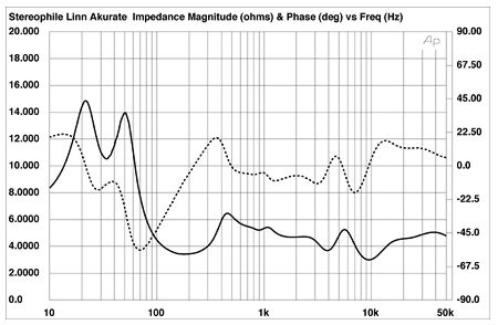

Re impedance curves, I'm not so concerned now I've read around a bit. I still haven't found impedance plots, but my speaker's larger sibling is the same design except for the bass end, and a plot of these was published in Stereophile.
Measured impedance for Linn Akurate 242s (Impedance is the heavy line)​
I will definitely try out the 4 ohm tap on whichever I get, and even the 2-ohm that the Sevens have.
