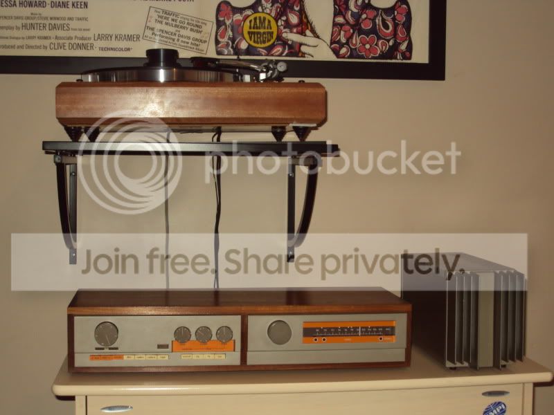

33/303 net audio upgraded, it sounds great! :D
It's an absolute classic Marc - but you need a Squeezebox sitting on top of that lovely Preamp-Tuner sleeve!
Very cool indeed! It brings back some fond memories too - my first amp was a 33/FM3/303 with the same wood sleeve. A design classic IMO.

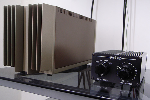

I've kind of revisited to some degree it as I've got another 303 in my second / TV system:
It's a very old MkI 303 dating from 1969-70, one of the first I guess. I've just had it serviced by Quad. The pre is a Audio Synthesis passive and it's driving a pair of Klipsch Heresys. It sounds rather good. I'm playing Spotify through it as I type.
