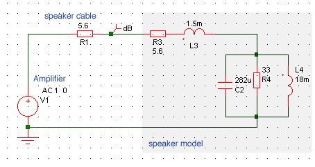

Here's a very simple electro-mechanical model of a single (bass) driver in a box:

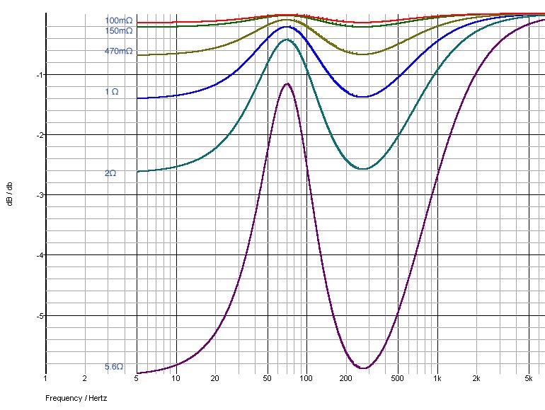

Here's the response you get as you increase the cable resistance feeding it (this assumes the amp is 'perfect', ie zero output impedance!)
-the numbers on the left are total output Z (amp +cable resistance)
While we could argue over the precise shape of these curves depending on exact speaker type, the underlying trend is totally undeniable: thin, resistive cables both emphasise the speakers' bass 'tuning' and reduce the absolute amount of bass energy you get - look at the way it falls-off between the peak and everything above c.500hz (midrange) False emphasis on 'rhythm' , anyone..?
Further note that valve amps often have an output Z of 1-5ohms which, when used with smallish speakers, definitely interacts like this to result in the same perception of 'great bass' ...! In fact - it' s all just uneven/over-emphasised bass.
BTW, many Class-D amps do this intrinsically, too... due to the required LC output filter.
As far as cables go, the answer is easy: keep their total resistance below 5% of the nominal impedance of the speakers. IOW - use thicker cables for longer runs. No magic involved!
