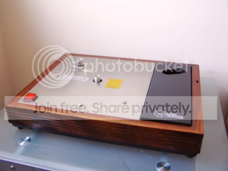

Currently the TT is completely dismantled and sprawled out on the work surface looking very sad. First pics, starting with a box containing enough polystyrene quavers to re-float the Titanic:

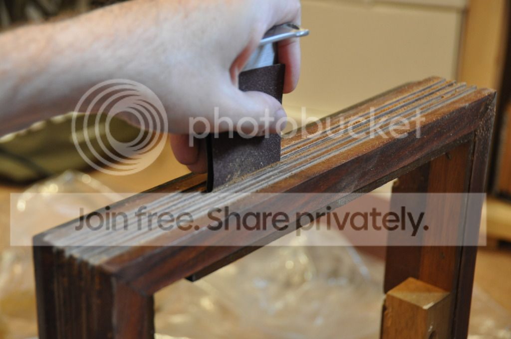

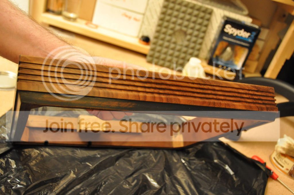

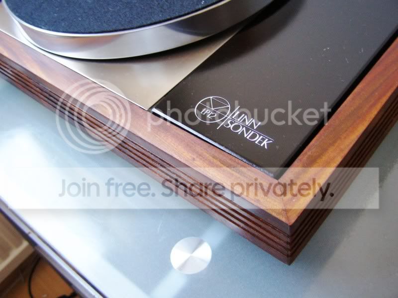

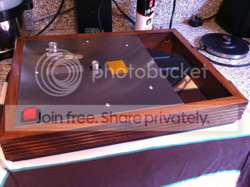

Rob came over yesterday to kicj a bit of life back in to the frame of the LP12, as it looked a lot better in the eBay pics above than when it arrived. It looked like someone had put a tinted varnish on it that hid the grain and was rather goopy.

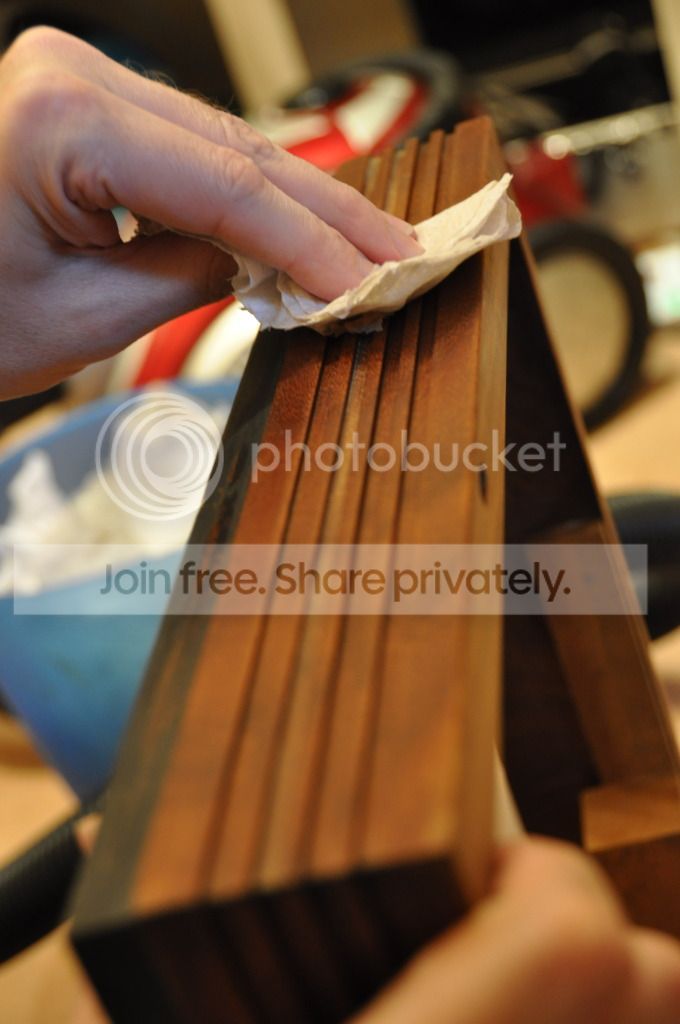

So a few quick photos of what we did, should anyone want to restore a bit of wood :)
1)Firstly we sanded off the old finish. This took a lot of work, especially to get inside those fluted slots!
Repeat with 180grit, 320grit and 400grit. Couldn't get any 220grit at the shop annoyingly.

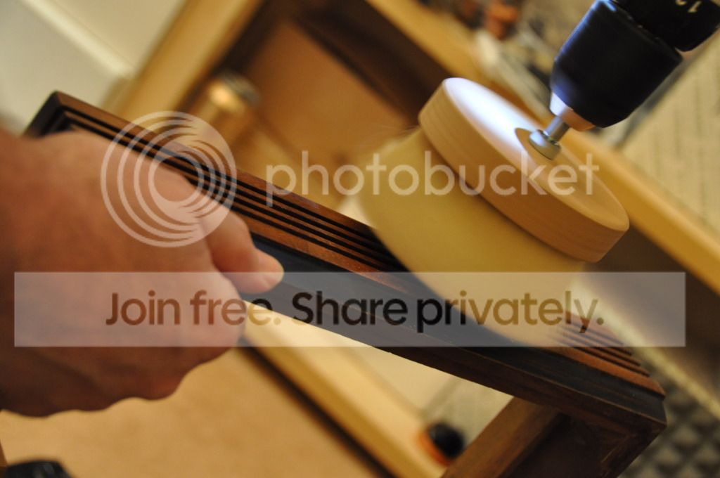

2) Clean it up with white spirit.

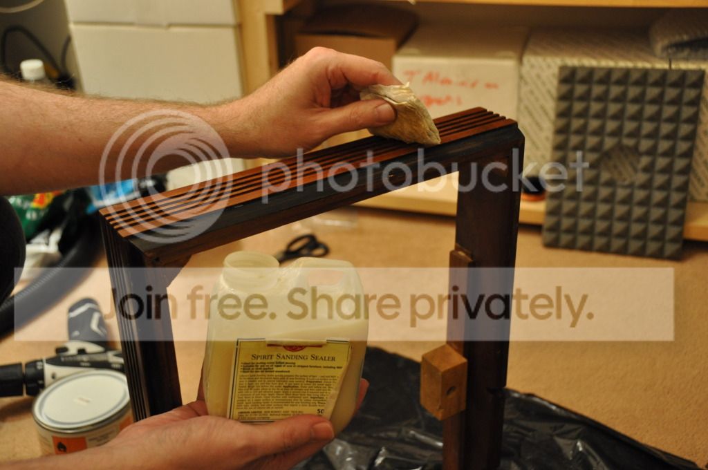

3) Rub on spirit sanding sealer with a cloth. This will stop the wax sinking in to the wood later.

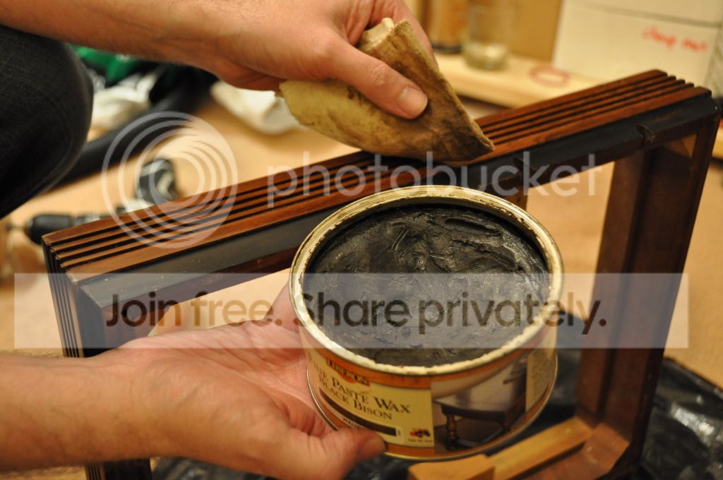

4) Apply a small amount of dark wax. this helps hide any dust that might still be in the pores of the wood. Allow to dry.

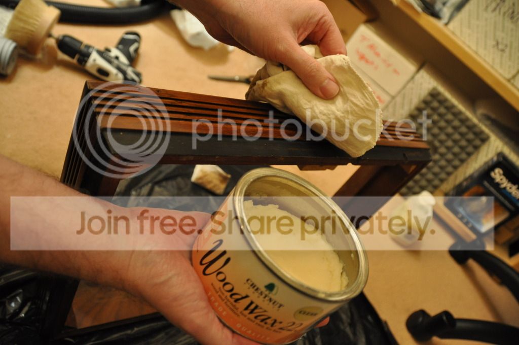

5) Apply clear wax of choice. I like Chestnut as it gives a good shine and is soft to apply. Buff a lot! Depending on the wax you might need to leave it before buffing, or buff directly after applying.
6) Enjoy the look, and the smell ;)

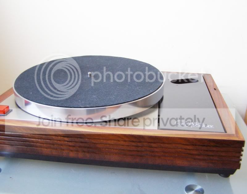

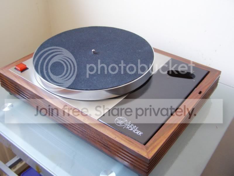

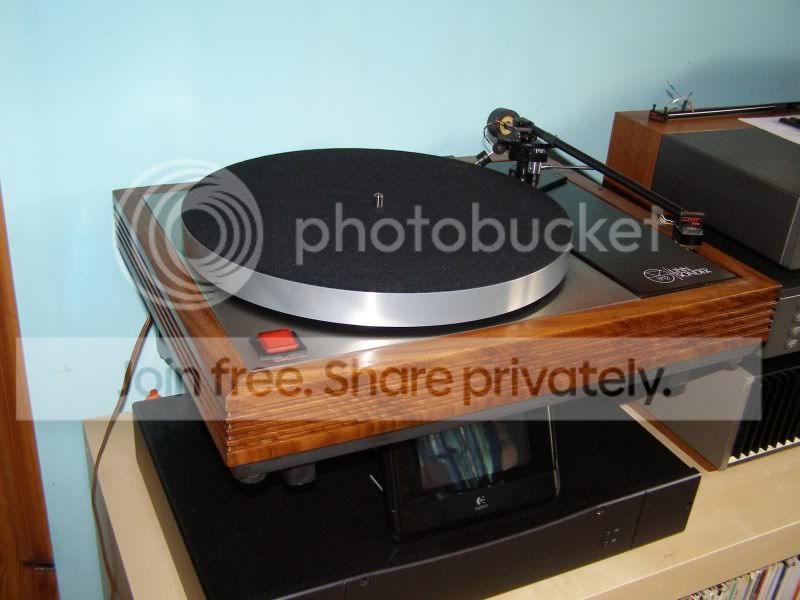

The finished deck with 774 and AT33:

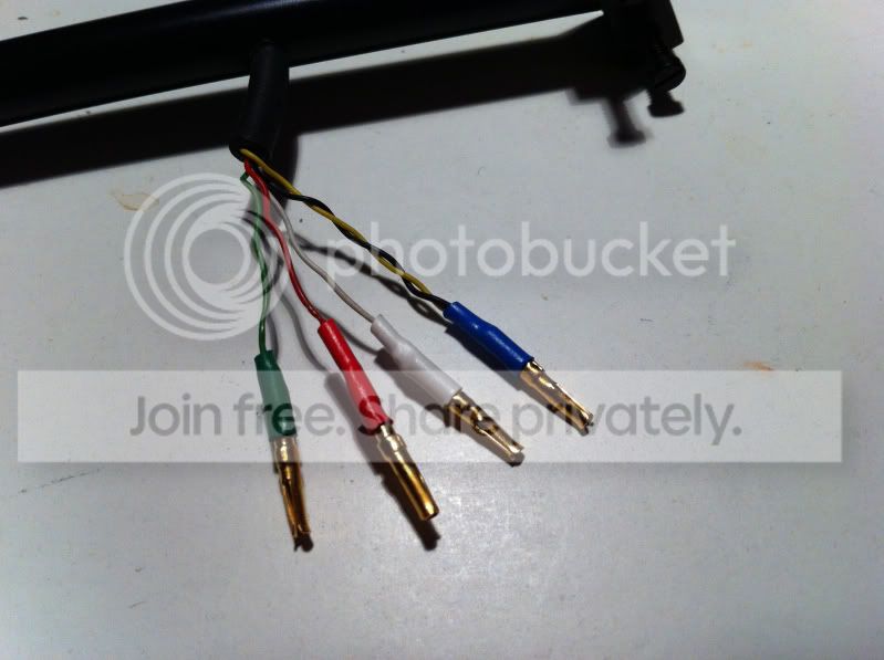

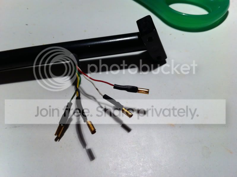

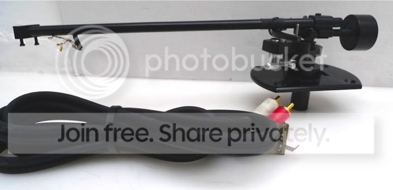

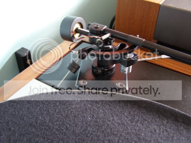

Lastly, the 774 is in very nice condition but I'm lucky to have two wands. I've used Cardas tags on one and the more usual type on the other:

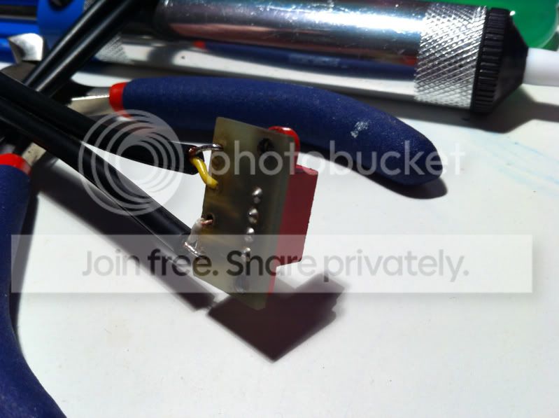

One weak area with the 774 is the cable plug arrangement. This is tiny and not suited at all to heavy interconnects - so don't use one. Use a thin, simple coax so that you can actually thread the cable through the holes on the tiny pcb:

+!, superb. The effect of a little elbow grease on that plinth is remarkable.
