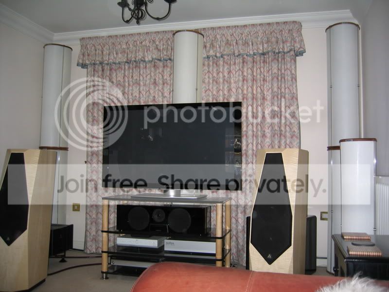

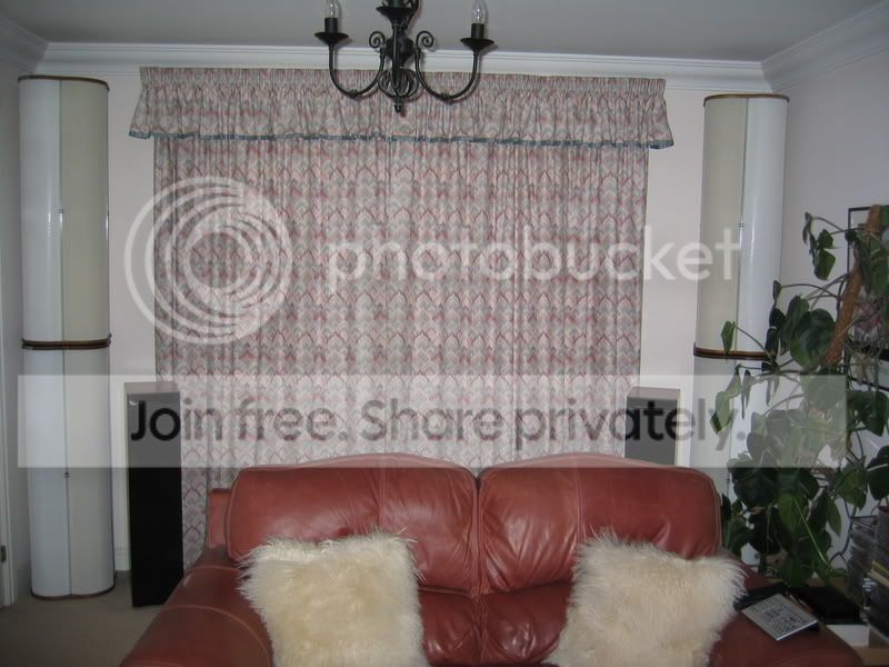

I have installed the Acustica Applicata DAAD's to tame resonances and 'tune' the room. I have 12 pieces strategically placed according to the bespoke room plan computer generated by Acustica Applicata in Italy based on the information and pictures I supplied.
Bass is now tuneful and present everywhere in the room (not just in the peaks) and refections at higher frequencies are nicely controlled.
It was definately worthwhile dealing with 'room' issues to get the maximum benefit out of my system components.
