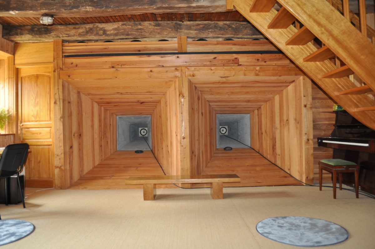

How about this?
Midway through building a new room myself here, and hoping that I do have enough height for the 4.8 x 5.7m floor design - nearly 14' seems a bit high for a ceiling!
These places along with a google on listening room dimensions helped a lot, plenty of ideas on construction design and products for soundproofing / flanking measures.
