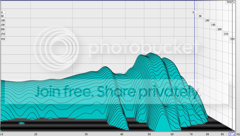

Below is a real world example just taken from my room today. Note the resonance at 40Hz and the improvement of the decay.
This is without EQ.

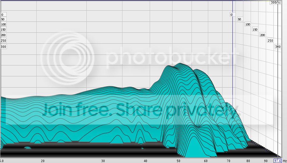

This is after EQ.
You can also see 3 modes piled up near each other around 60Hz. You could EQ these with a single notch on the centre frequency and a reasonably wide Q. However as you can see they are actually 3 resonances near each other. If you EQ them out with 3 parametric EQs of narrow Q then the time domain will be much improved over just using one general EQ bank. That's why graphic EQ is not ideal for room EQ; you want to identify the individual resonances at play.

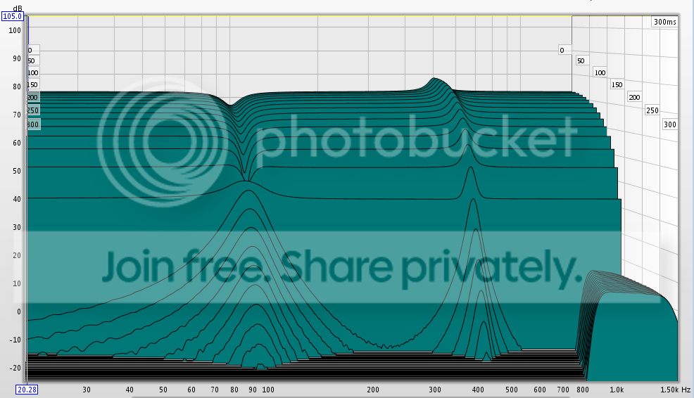

To expand on this a little, below is a waterfall plot of a normal parametric EQ stuck directly in-line with my measurement system. There is no speakers and room here, just the electrical circuit.
The EQ was set to have a -6dB notch at 100Hz and a +6dB boost at 400Hz. We can see the behaviour of these filters now, and how they are capable of reducing the decay of a room mode beyond the simple 'frequency domain' attenuation. Note that even the negative deductive EQ at 100Hz produces a positive output later in time. This is because of the 'minimum phase' behaviour I mentioned earlier - a set of rules basically that define how this type of filter functions and it is the same behaviour as room resonances (provided you stay in the same listening position).
