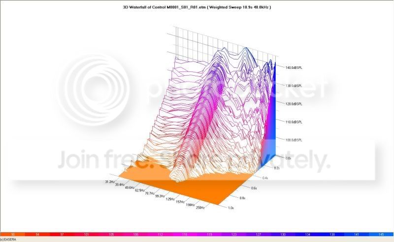

    Not got as much time as I'd like to dedicate to this right now but I did look a little further into it.
    For now I've come up with a bandaid just to make the system listenable, actually its much better but I'm still aware of a problem in the bass. What I've done is put a high Q and deep notch filter in at 70hz along with digital room correction. Oddly despite the deep notch showing as a severe drop in the frequency response its not that noticeable because its filled in by the resonance. Hardly fidelity though since your listening to controlled boom at 70hz.
    Before treatment
    [​IMG]
    [​IMG]
    After and with notch at 70hz + DRC
    [​IMG]
    [​IMG]
    I'm now 99% sure its the cabinet at the front of the room and loudspeaker positioning in relation to it. I dropped the cabinet face down onto the floor then ran a tone generator with sine through the right speaker as before and the weird phasey boom around 70hz disappeared.
    That's a bitch because the cabinet absolutely has to stay put. I'm now looking at ways to lessen the problem and here's what I've come up with:
    - Perhaps as Simon pointed out, the problem will be smoothed once the left channel is playing thus placing another low frequency source within the room. Usually such a move would smooth bass problems. But I'm not at all confident this will be true since the left channel is in a mirror image situation with the right so it makes sense that the same problems as already noted will be present.
    - Its been suggested to tune the existing panel traps lower by subbing the 4mm ply with 6mm or 8mm. I'd rather not go this route unless absolutely necessary since it will mean destroying a lot of hard work. Consider this a final option.
    - I was wondering about membrane traps located in the alcoves where the loudspeaker sit? Each alcove could accommodate 1x 60cm x 170cm panel and 2x 40cm x 170cm panels. All with a max total depth of 4". Can these be tuned low enough to affect 50-100hz with the concentration around 70hz?
    - What about multiple small subs? I could very easily and quickly build 3 small sealed cubes based around the unused Peerless XLS10 drivers I have already. I've read the Harman paper about multiple subs for smoothing room response and one at the mid point for side walls and rear wall looks promising. These would work from around 80-90hz.
    Any thoughts on these idea's?
    I like the idea of trying the membranes around the speakers first 'cause its cheap and no problems building them. But will they work and how would I design them?
    ShinOBIWAN, Dec 14, 2008
    #47

    Likes Received:
    Shin,
    Can you redo those waterfalls but show 500ms and about 50dB drop in level (you currently show about 30dB drop)
    Also, can you play around with the settings to show "time slices" and turn off all the color fill-in. Here's an example of the sort of outputs we look at when hunting for room modes...
    [​IMG]
    andyoz, Dec 14, 2008
    #48
  9. ShinOBIWAN
    ShinOBIWAN
    Joined:
    Jun 7, 2006
    Messages:
    710
    Likes Received:
    Andy the measurement with DRC, the notch filter aren't much good since they hide much of the problem.
    Instead here is a measurement used for time alignment of the drivers and has deliberate delays applied to each driver in order to separate the peaks of their impulses and allow calculation of the required delays. This is why you see some destructive interference in the upper range. Below 100hz is fine though.
    Another thing to note is that the large resonance is appearing at 42hz and the problems between 50-85hz don't appears to be a resonance at all. They actually look like pot holes in the graph and occur within a regular interval. This may be the phasey nature I was talking about. By far the 70hz problem is the most annoying, the one at 42hz is virtually disappears after DRC.
    Here's the plot. I cannot get time slices with this software since it doesn't appear to work that way, FFT uses time slices whereas this uses wavelets in stockwell transform.
    BTW I lengthened to 500ms and -50dB range. All else is same as above.
    [​IMG]
    #49

    That's easier to "read".
    Still not entirely sure what's going on around 70Hz though TBH. If the room is about 2.5m wide and 2.5m high then you could be seeing the two room modes interacting with one another. Although your test with the cabinet door off seems to suggest otherwise. Where was that measurement taken? Is it in the middle of the room about 1.2m above the floor?
    I assume the 42Hz mode is linked to the rooms long dimension. IS the room 4m long.
    #50
