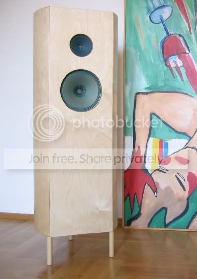

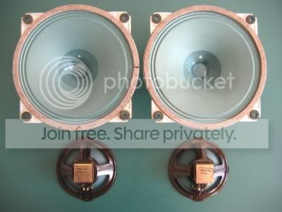

For those unfamiliar with Saba's, some pics. (shame about the painting!)
and, following from another thread, the midrange on these is generally very 'ok'!

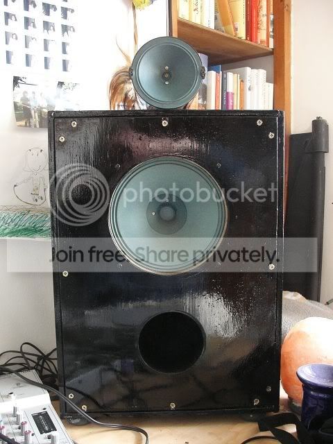

The Sabas plus something else to augment the bass sounds sensible if they are really nice. Also a plug in cordless doorbell may help ;)
Yeah those are like mine, but I just have the 8"ers and the tweeters in open baffles. They sound really alive even when whisper-quiet. It's just the bass thing. Those reflex enclosures look as if they might supplement the bass a bit but maybe if I take them out of the open baffles something might be lost. And there's a lot to be said for matt black paint.
