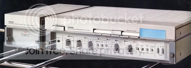

Trio (kenwood) did a similar thing back around 1980 with their upmarket Sigma Drive series of amplifies. Effectively used sense wires to place the speaker cables inside the feedback loop.
Nice amps. I bought the top model with large external PSU a few years ago to try and while it sounded fine it went faulty soon after. Very complex thing and i just couldn't face removing hundreds of (different sized) screws and removing the plethora of pcbs to investigate.
Ah, Rob, if the PSU was for the power amp then it would have been the "all but impossible to find" 500S - there were only prototypes made if I recall and the design was prone to becoming unstable (so Tom Whelan -I think- informed me) but the 100S and 50S designs were very good.
I recall tripping over that Rob. It would be good to hear it one day.
