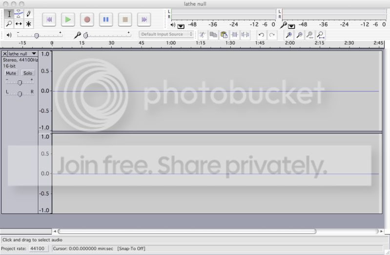

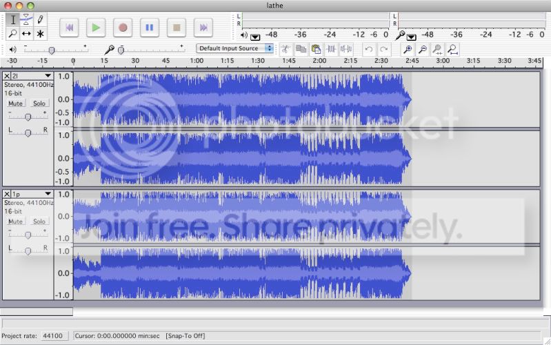

Next, using the same Meridian 206 via optical out I recorded track 1 from both discs into Audacity, inverted one file and mixed them.
The result as you can see is a perfectly flat line.
Therefore the output from the Meridian using these disc is identical - 100% perfect and they cannot possibly sound different.
If you want to hear the null track a link appears below, but honestly, you will just hear complete silence - not so much as a tick!
Here is the screen shot.
Top shows the two discs with one inverted, bottom shows them mixed together.
Wav file:
http://www.mediafire.com/download.php?tjummwtlmwl
Happy to supply the source files to anyone for verification.
