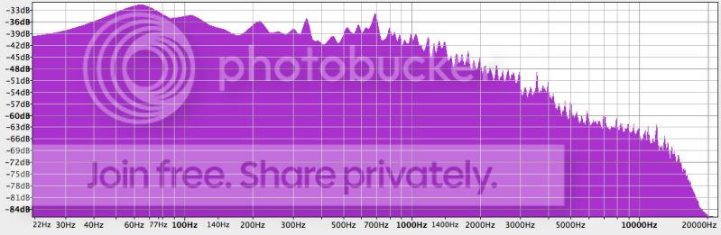

At long last and as promised, here is the ECC83 comparison thread.
Lots of people seem interested in tube rolling in order to fine tune the balance of their valve amplification and the ECC83 is fairly common in pre amps and phono stages, not to mention the input sections of some power amplifiers.
Here we have a selection of ten tubes for you to try.
Each was inserted into the output buffer position of a World Design phono stage. This uses one tube in that position and because these are double triodes, one half of the tube serves each channel. A type 5751 is also included as this close relative to the ECC83 is preferred by some.
A spectral plot is also provided for each tube and if you view these carefully you will see that clear differences exist between these tubes, but please listen to the files first before looking :)
The plots reveal nothing dramatic in terms of balance - so if you feel that, for example, one tube has waaay more bass than another I'd suggest a cold shower or a walk around the block before listening again ;)
The track chosen is a nice bit of swing in the form of 'Mack the Knife' .
The tracks were recorded in silence (so no microphony) and the phono stage was running direct into the ADC, recording at 16/44.
Tubes perform differently depending on how and where they are used in a circuit, so this is merely intended to highlight differences as used here, but this type of use is common nonetheless.
Enjoy!

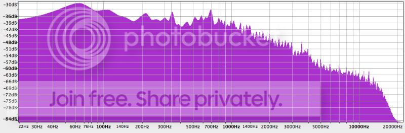

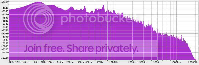

Spectral Plots:
Brimar:
Telefunken:
Mullard:

I've not started listening yet, but can someone give me an indication of what I'm meant to be seeing in the graphs - they all look identical to me, and I mean identical! How is one supposed to interpret them?

There are some eye-bendingly tiny differences in the graphs.

I did take some quick n dirty noise measurements from the display on the ADC/DAC. Essentially just a level reading of noise from the phono stage with nothing playing. There is a about 8db between those tubes and I'll put the figures up later, so quite considerable.
If you examine the graphs you can see differences of up to 3-4db and that is enough to change the sound over a broad range.
The Mullard for example is a few db up at the bottom and similarly down at the top.
If I replicate that effect via EQ it can clearly be heard.

With electronics I think +/- 3db is quite a lot and certainly enough to alter sound balance. Far greater than most SS amplifiers via line input, or even CD players.
Pick a point on the purple curve for a few of the tubes and reference it to the levels on the the left hand side.
