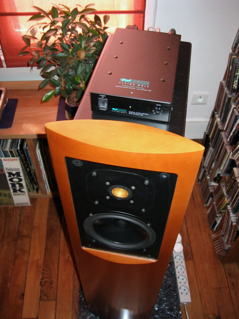

Incredible, four Impulse users in one thread!!! I've had my Lalis for a couple of months now. The midrange clarity and dynamics are outstanding, but in my fairly small room, the lower-bass was boomy, which was cancelling the mid/upper-bass. Even pulling them clear of walls made no real difference. However, after experimenting with stuffing, I've now achieved good tight bass by stuffing the top of the horn mouth with Decron.

You should hear some H2s or Taus. The Lali's are MUCH more forgiving than the H2s, but driven well, the H2s are awesome.
I'll be experimenting some more soon with a Behringer 2496, could be interesting.
Where in the country are you and what are you driving yours with?

Stuffing the horn isn't ideal as it can also make the sound muddled and constricted IMO. Speak to Simon about bass traps ;)
Yes I agree, no stuffing is generally better for most horn designs, but Lalis are folded Voigt Pipes, which are notorious for bass related problems;) IMO, judicious stuffing can help eliminate any half wavelength standing waves in these designs without compromising dynamics too much. After much experimentation, I'm now getting a fairly even frequency response with damping opposite the drivers and a little polywool stuffing in the throat.
