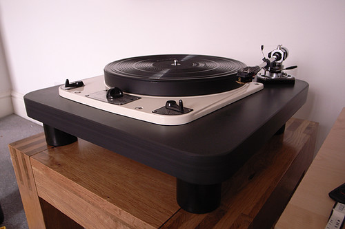

Thanks. I designed a skeletal plinth a while back to handle anything up to a 10.5" tonearm with ease. I think I'll give the VPI a try... no harm in trying.

I understand BUT the plinth I have does not have a problem with anything like that. Yes it's a big plinth but then I have a 1300 sq/ft office which needs to be filled!

I disagree. My plinth is wide enough on the right-hand side to accommodate a 10.5" tonearm along the same line as a 9" - meaning I don't need to shove it 'up top' like in your pic.

Maths...it's not rocket science is it ;) I see with 211 as with the Linn arms the distance can foul on the top plate. The VPI, Rega and most 10" and above tonearms, the mounting distance is 222 or above so can be used on the right hand side of the top right hand bolt. The clearance for a Rega mount (222) is fine if used to the right of the platter. My plinth is slightly wider on the right compared to the image attached.

Ok, now the goal-posts have now moved: 222mm is not a 9" arm as the thread title specified, it's a 9.5" arm! That gives you a bit more wiggle-room.
