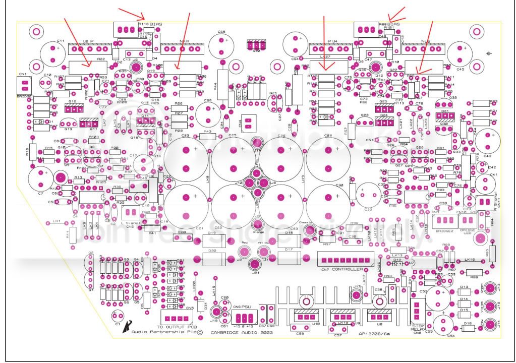

Cambridge Audio Azur 640A Amplifier Bias Setup​
To set the bias on the 640A Amplifier:
Measure the voltage across R22 and R100 (Left channel) individually; they
should be adjusted using Preset R116 so that the voltage measured on each
resistor is greater than 13mV. This procedure should then be repeated for the
Right channel by measuring the voltage across R52 and R69 whilst adjusting
Preset R68 so that the voltage measured on each resistor is greater than 13mV.
I've drawn some arrows on the PCB where the parts are:

Amazingtrade - if you are comfortable doing the adjustments yourself and have a good DVM then have a go.
If not, take a print of the above and take the amp along to a TV/electrical repair shop and ask them to adjust it for you. Give the amp 15 minutes or so warm up but the adjustment will take them no longer than 15 minutes. Should cost very little.
It says 'more than' 13mv which isn't exactly helpful - probably means distortion hits a minimum at that point and going higher doesn't help.
Get them to set 15mv on each side and should be job done.
