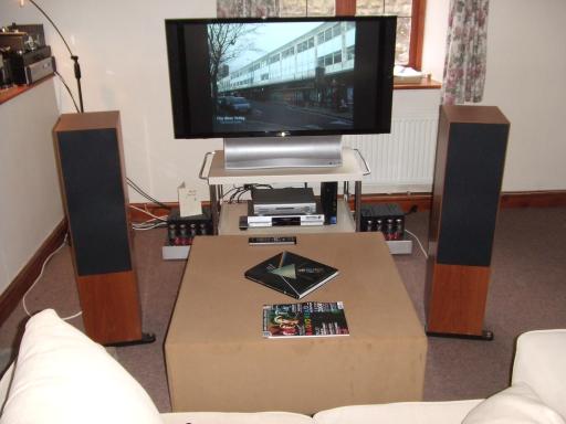

Room is...4.2m x 3.9m, so almost square.
Speakers 1.2m from rear wall, as central as possible within the 3.9m width, 1.6m apart, near field listening.
Due to doors etc, this is the only position they will work in.

Mr. Carbon, you need to put an absorptive acoustic panel on the left hand wall at the first reflection point. You and the speaker seem to be very close to that wall and you will have a strong reflection introducing all sorts of nasties. You would also do well to put some bass traps in that corner behind the speakers. It looks like you are quite far from the right hand wall so that may not be as important to treat.
Thats really the minimum you should do. If its a dedicated room though, and you have £2k to blow, honestly, hire an acoustician and let him have free rein to get you the best sound possible.
