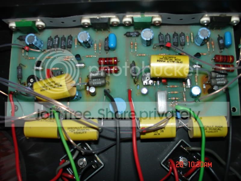

Hi Jez,
That diagram mirrors the P170 I worked on recently, but it was the early Mk1 (with red panel trim) so perhaps the circuit you describe was used in the Mk2 and later amplifiers.
Here is the PCB shot of the P170 before any work was done:
You are certainly correct about the P170 Rob. It even says P170 on the diagram. The diagram I have is identical other than that yours has had "270 370 470" written on it. It is not the correct diagram for those models. I had missed out the P170 from my comments because it was before my time at MF and I never worked on one! I stand by everything I said pertaining to all those other amps :)
The changes you mentioned would certainly be welcome.
I do like the simplicity of that circuit though.
Did MF have a fetish for big yellow poly caps in those days! :)
They turn up in lots of MF kit from that period.
